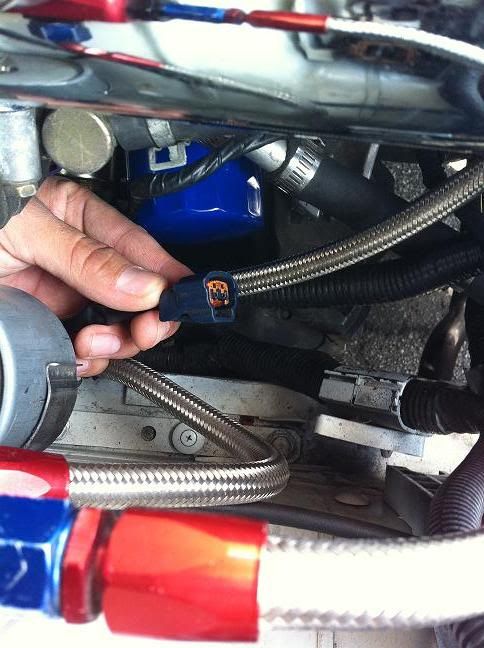

Well, i have 3 connectors on that harness. Two of which are knock sensors and the other is a blue colored connector. I would have guessed since the sensor's connector is black, it should be a black connector on the harness, but mine is blue. Nonetheless, here is a pic of the connector that is not being used....Is it this one?

most of the plugs on our harnesses only plug into one place so its kinda hard to get them wrong.

Yeah that blue plug is the correct one.

There's three different plugs down there, they all look the same but one is keyed differently.
The brown plug is the IACV (although they called it the AAC, Auxilliary Air Control or something on the RB25).
The purple plug is something else, forgot, it's been years since I built my Rb25. I didn't wire it in on any of the RB harnesses I've built.
The black plug is a coolant flow control valve, most people don't use it. If that's what's not plugged in, don't worry abou tit.

Brown is AAC
Purple is for the A/C
Didn't know there was a third one, but most likely useless.

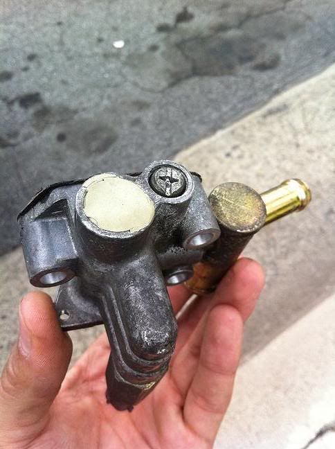

Was cleaning my IACV today and noticed next to the adjustment screw, mine has some puddy there. Does anyone else look like this?
