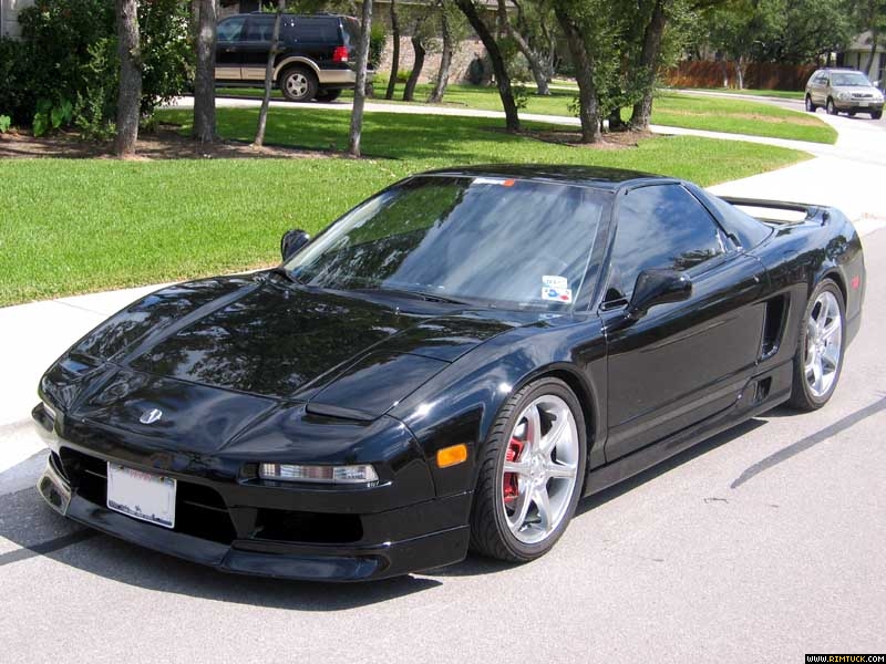

If you're worried about if these sizes are stretched, heres a 215/17/40 on a 17x8 on the front on this NSX:

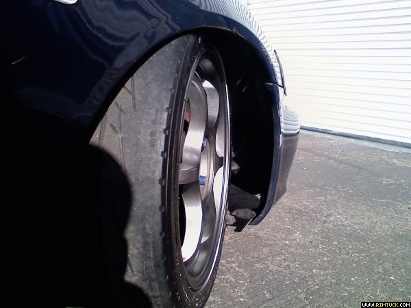

Here's a 205/40/17 on a 17x7.5 on a 2002 Accord.
