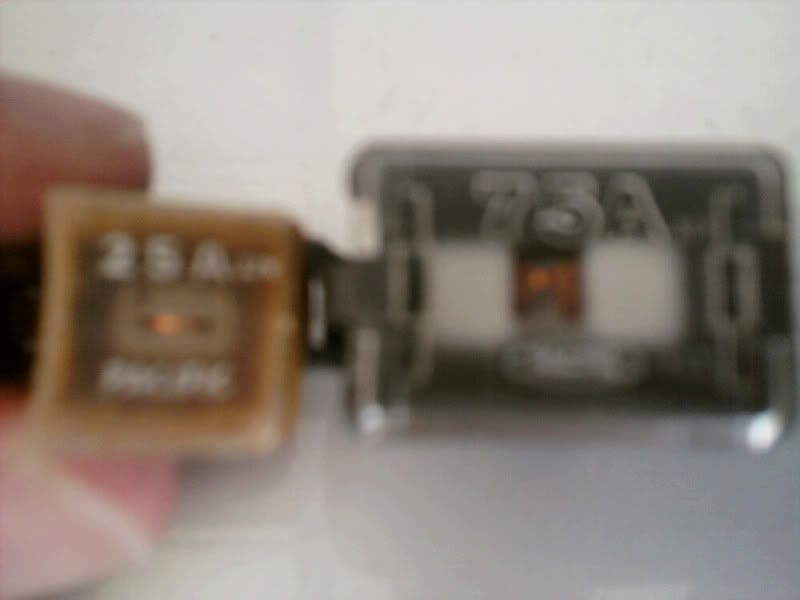

Old 05-20-2011, 11:49 AM   #11
Artigo
Join Date: Jun 2009
Location: East St. Louis
Posts: 68
Artigo is an unknown quantity at this point
Originally Posted by onehundredoctane View Post
ALT fuse, yes. Check the ENG CONT fuse as well.
They both look good.
Pics a little blurry, but here they are
Artigo is offline   Reply With Quote
Old 05-20-2011, 12:00 PM   #12
camaro379ss
camaro379ss's Avatar
Join Date: Mar 2011
Location: Indianapolis, IN
Posts: 363
camaro379ss is an unknown quantity at this point
I feel like I am trying to watch 3d without the glasses lol.

Old 05-20-2011, 12:04 PM   #13
Artigo
Join Date: Jun 2009
Posts: 68
Haha sorry about that. I was outside and couldn't get my camera on my phone to focus close enough to where you could see the fuse.
edit: I also realize there is a 10a ENG CONT fuse as well and that one was good too.
