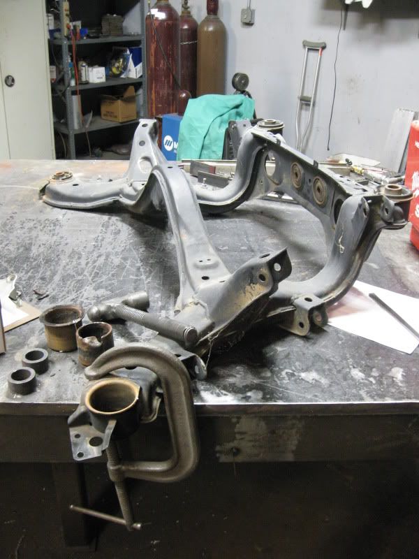

Depends on who's doing it of course; there is no expected value for that. I just did it on mine. Wow, what a bitch. From what I seen, you only need to burn out the ones on the RLCA and FLCA's. The ones in the subframe I used a drill to eat away the gap. once I got the centers out, its a matter of using the a reciprocating saw to do the bulk of the work, then swap out for a hack saw. The blade will get pinched once you cut through the sleeve, then use a drift and knock it out.

Pressing the ones out of the RLCA's is very difficult to fixture. I only burnt those out so I could get the saw in place. The bushings can only come out in one direction. Pressing the bushings out of the spindles is fairly easy and straight forward. The subframe is also very difficult to fixture in a press, and I've got a pretty large one.

^ya know it really wasn't that bad, maybe 2 hrs. Have you tried it with an air hammer? It's still a bitch to find something perfectly sized to hit the outer ring. There isn't much of a ledge.

It makes quick work of subframe bushings. I havent done them on my 240 yet but on multiple other cars. Its all about selecting the correct bit and not letting that damn thing jump around. Once it bites into the outer ring it will form its own ledge and go to town, but yea that ledge is pretty hard to get.
But in general it would take you less than a few minutes per bushing on average.
