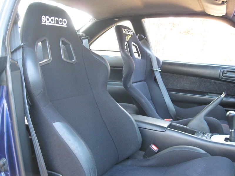

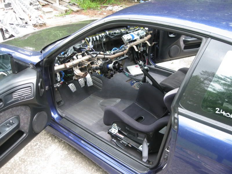

Same turbo now same seats; lol... I mounted my Corsa on a NAMS slider rail using the highest position on the front "L" bracket and flipping the rear "L" bracket and using the now lowest position it has. I have trouble seeing over my dash and I'm 6'1"
For my passenger seat, I'm using a Wedge Engineering rail since the Toreno is a bottom mount seat. There isn't a slider under it but it's got to be the lowest one on the market; it sits against the hump in the floor.
You can kinda see what I'm talking about in this picture; too bad the seat belt is right in the way.

So with that rail does the seat actually fit between the rails? I with my BC rail the seat is barely too wide to go as low as the rail will allow.

yup. The seat just barely fits between the rails, and I think it's only allowable due to the fact the mounting holes on the rails are slots. I live it though. Not only am I really low down in the car, the seat is SOLID. They extra effort will really pay off once I get my cage underway. A buddy of mine has his sitting up so high that his head is right next to his Autopower cage. Just feels awkward to sit up that high.
