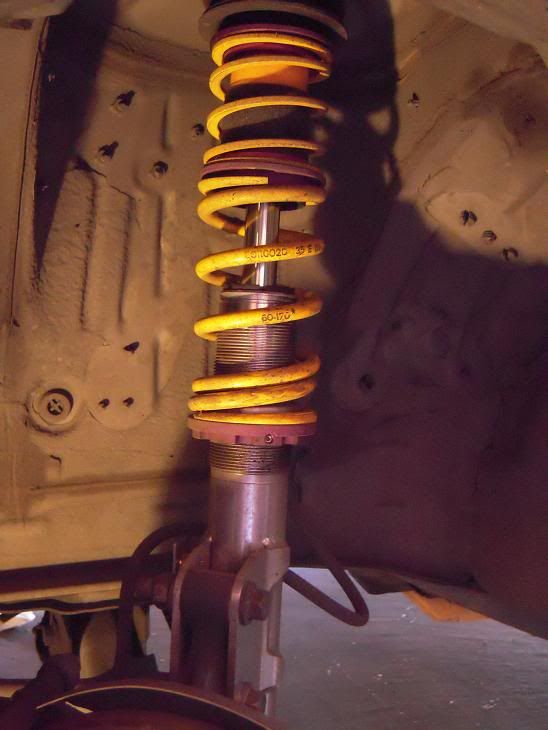

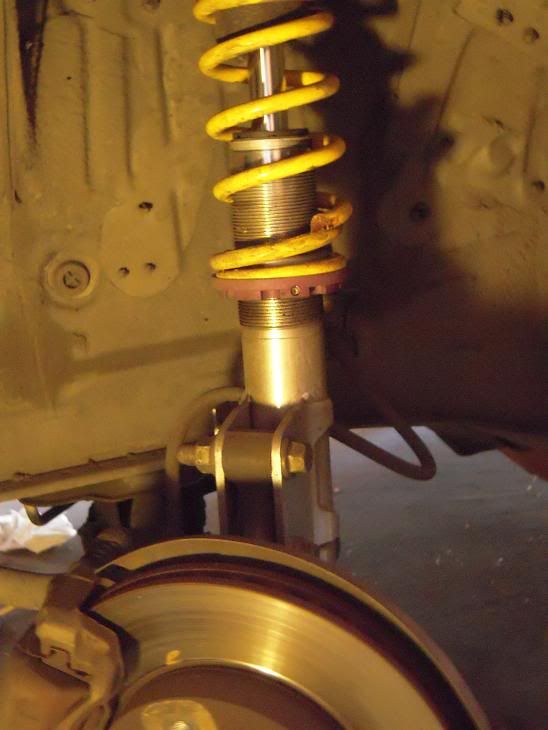

So for about a week (when i began to notice it) my s14 has been feeling odd, the steering and handling have been a little off and i have been getting more vibration through the steering wheel.
So today i jacked my car up and discovered this little surprise

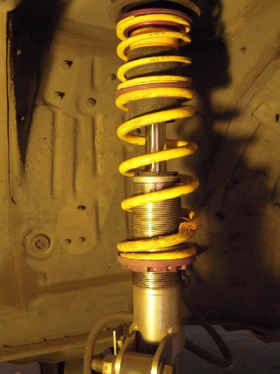

Springs look close together?

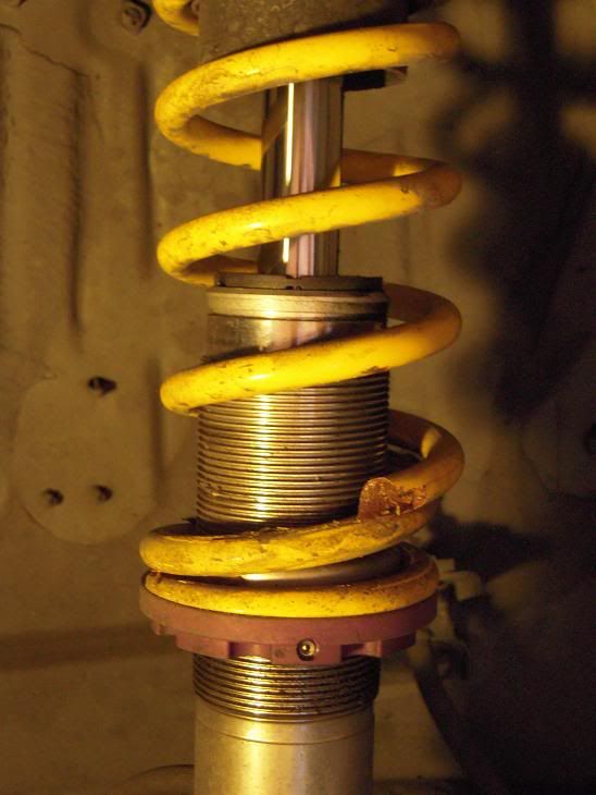

take a 1/4 turn and find this
A little background, installed the variant 3s about 8 months ago. Never tracked, not lowered to the maximum, pretty much my daily. Also city streets in my neighborhood are pretty decent without enormous potholes.
This didn't happen on the much cheaper Ksports that was ridden on for the last 5 years. I felt that if i should upgrade the car i should make the upgrade worthwhile hence the variant 3s..
Anyone else have a spring shear on them?
Kind of disappointed now

Damn dude what a bummer I would be quite upset if the same happened to me. Hows the warranty on those?

If you bought them new, they should send you a replacement spring. Even if you did not buy them new they still may, since such a major defect reflects poorly on KW, and as a respected brand I would think they will want to protect their reputation and make you happy.
Although this makes for a good excuse to upgrade to Swift Springs.
