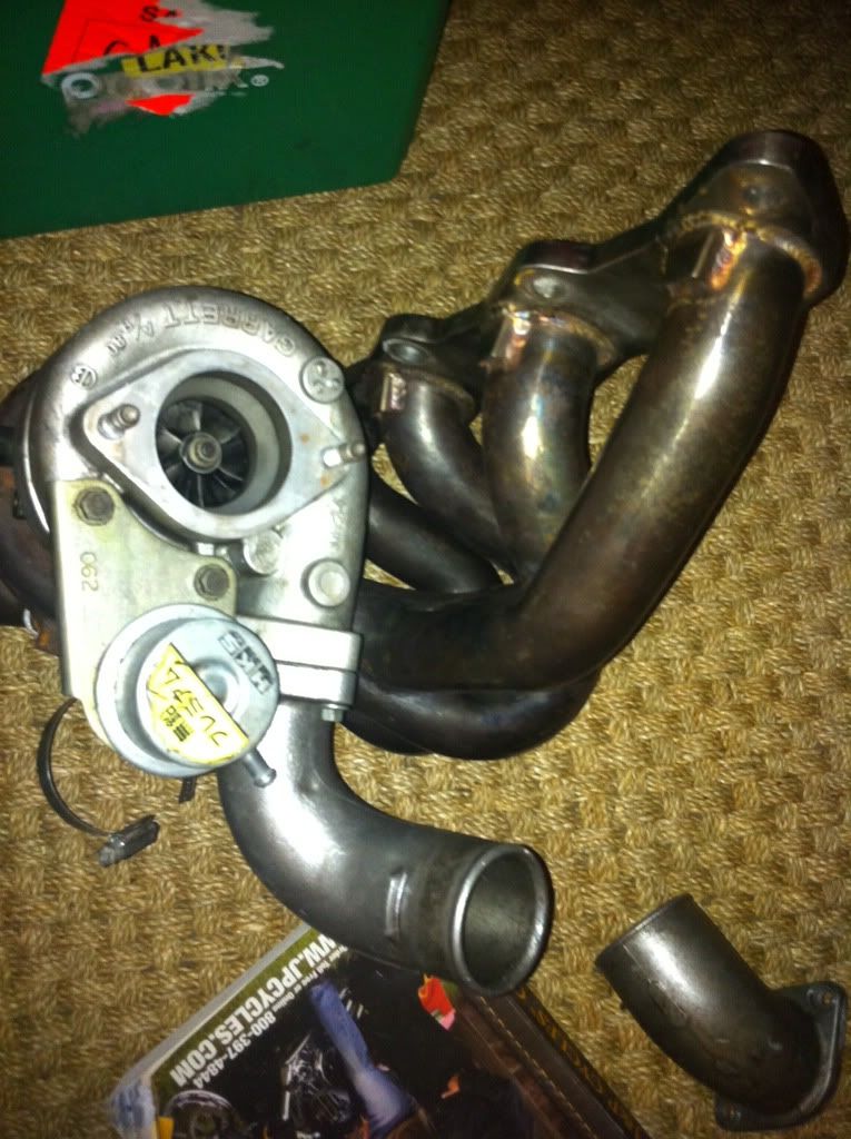

help identify this turbo... T25 or T28??
I bought this turbo as a S14 T28... I'm sure there's someone out there who can identify what this turbo is, is it actually a T25?
Compressor side: M-24 a/r .80
Exhaust side: M-3 a/r .64 3xv 2382-24
it also has an hks wastegate actuator
thanks

there should be a tag on the center cartridge. That'll have the information to help identify what turbo you have.

yep looks like a T25

yeah, it looks like a t25. t28 compressor housing is bigger than the turbine housing.

Looks to be a t25. The T28 is clocked differently around the intake side, look at the flange with the 2 studs compared to the T28 in the pic below.

so i'm thinking that this turbo is from a 96-98 180sx?
the .80 a/r on the compressor side is throwing me off...
all other t25's i've seen have a compressor a/r of .60

t25 it is.

SR T28 on left. SR T25 on right.

i see the a/r 80 as well and i am confused to cause my t25 says a/r 60. is it a s14 t28?
