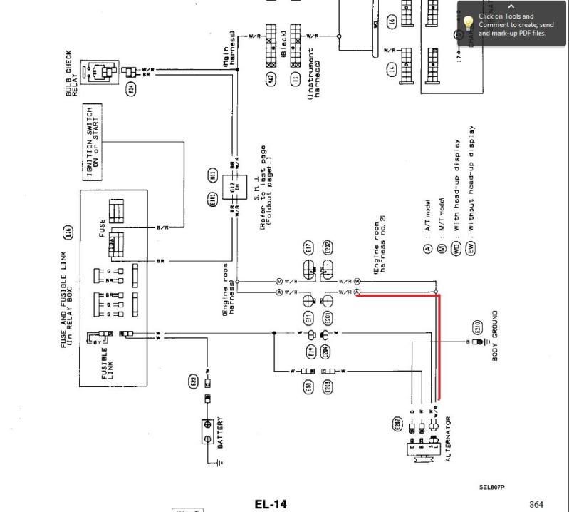

That white/Red Stripe wire is the Alt Charge light wire.
If that one is not connected the Alt will not charge

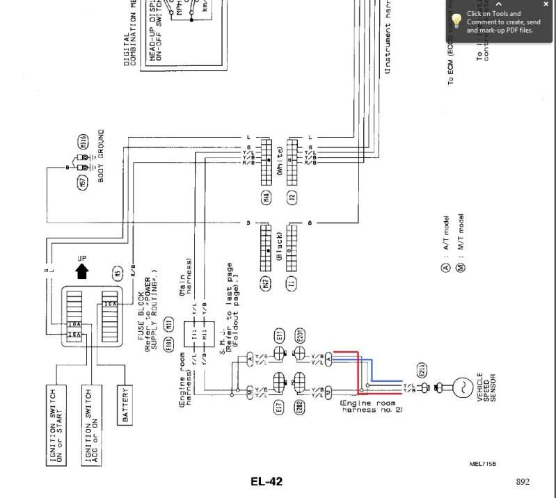

Does your speedo work as well? Those look like the Speedo wires as well

Dude Thats the plug for your Alt Warning and Speedo and Oil Pressure Switch.
Your Wiring is just really fucked up
They probably wired the speedo at the first plug comming off the speedo

The FSM shows you where it connects to, but the plug will connect to around the fuse box on the passenger side strut tower
