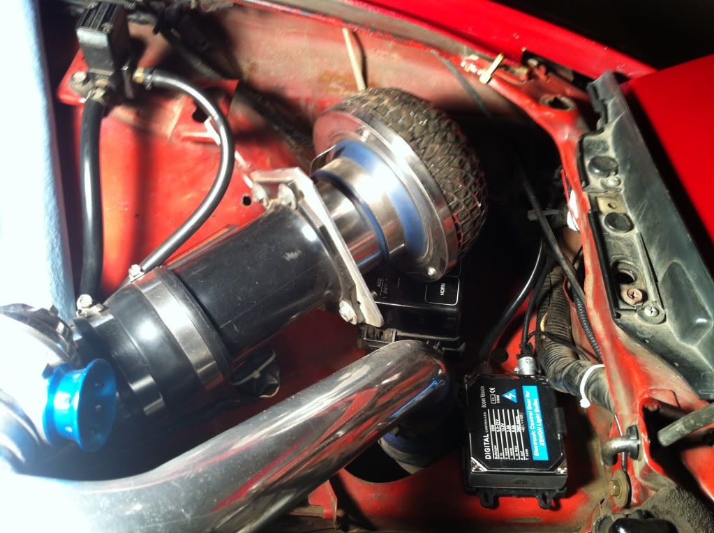

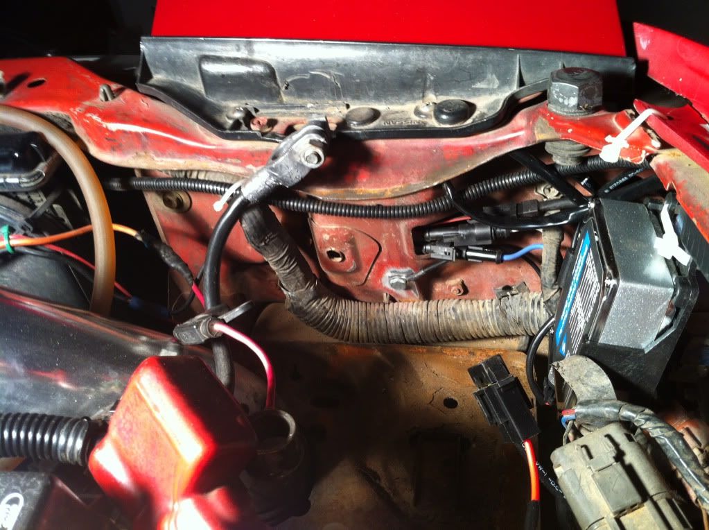

Yea I was just looking for inspiration for clean installs. Anyways if anyone searches this thread heres how I did mine.
For the battery side I made a ground about the wiring harness and ran the wiring to the driver side in front of the radiator so it isn`t visible in the engine bay. I mounted the ballast against other wiring that was already there and the other box thing up under the fender with the double sided tape provided. Just use alcohol to clean it up nice and it should stick well.
Driver side I used a hole that was already there (bottom right of the pic) for the ground, and mounted it in front of the hot pipe.
So with the battery back in you can hardly see the one ballast and all wiring is pretty much hidden.
