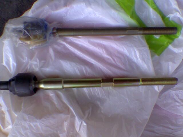

i never thought the day would ever come, for the suspension revamp :D
yeah so i'm kind of a whore and got kind of excited about getting some new pieces for the car and wanted to share.
first off, SERIOUS props to SPLparts for ultra quick delivery and for offering such a reasonably priced coilover to the 240 market. you guys rock!
the list of shitty parts is as follows:
-kts coilovers
-kazama tension rods
-nismo powerbrace
-energy suspension steering rack bushings
-jic inner tie rods
-kazama outter tie rods
-nismo 60mm studs front/rear
-kyo-ei plate spacers for the roller flushness
everythings installed but the kazama outter tie rods and es steering rack bushings. i guess its the same as most of you guys setups, bumpy multilink ride, but goddamnit mine has some WICKED bumpsteer. i really hope the height adjustment on the kazama's can fix that, QUICKLY. the spacers cleanup the sunkness of the 5zigens nicely imo. right now i'm running 2 8mm plate spacers on each front wheel so my setup is respectably 17x9 -1 offset up front, which isn't too bad. i have it setup at -3.5 camber, 8 caster, 0 toe.
i was looking forward to having this all on by the last event of the year and i did minus the couple parts. and i was most dissapointed to find that it was rained on that day pretty heavily. woooooooo-eeee 20-30mph rain drifting, makes you feel like a real dumbass. so i left really early. hopefully i can get good DRY track feedback by next years events.
here's the cheese:
i must say the extension on the jic inner tie rods saved my ass in many situations at the events, i've found the angle of drift is greatly improved while parking is so goddamn easy its crazy. i wanna go for the full monty when battle version releases their s14 tie rod spacers and run them with the jic's for some crazy angle.
oh well, thats my story, i'm happy with the setup. hope you enjoyed the pointless read
oh yeah, i also put on an s14 vlsd and what a piece of shit it is
ummm, ATS PLEASE?!

Is this your daily? Not bad, I have a very similar set up. Are your JIC inner tie rods the same length as stock? I installed my URAS tie rods over the weekend and it was about 3/4" longer than the stock and Tein inner rods. Nothing alittle cutting down won't fix, but just wondering if anyone else ran into this?
By the way, I haven't had too much of a bumpsteer problem, only on crappy canyon roads in santa barbara. Maybe you need another alignment?

The one J5 showed me, didn't look much longer than stock. But damn, yours look like it came off of a truck or something.

holy crap nooooooooooooooooooo! your inner tie rods are longer because it gives you more steering angle!!!!! Uras must give you CCCRRRAAAZZZYYY angle if they're that long, man i wish i woulda held out for them. but yeah my JIC's are longer than stock due to the built-in spacer system where it ties into the steering rack, just like yours have.
Ritz, get those jics dude you'll LOVE them!
yeah, this is my daily driver. i get off on having a pogostick looking suspension everyday, never tired of it, never annoyed with it. i kept thinking to myself what if i held out for the Tanabe pro DD's if they would've been better 10/8 rates are simply HOT.
studs? errrr, i think like 120ish front/rear at my local nissan dealer, still need to buy some plate spacers for the rear. i think 25mm should do the trick 17x9 -1 17x10 +0 muwahahha.
i haven't test fitted the rack bushings. at the moment of reckoning, i'll bust out the almighty dremmel and give it the pimp hand.

I installed TEIN tie rods, and they were MUCH longer than stock. But there was enough threads to just adjust them to length.
We counted the threads on the old ones, set the new ones to the same thread count. BOY! You should have SEEEN the toe-out! Talk about snow plow!
But, we just screwed them in and they worked fine.
The actual tie rod is almost an inch longer. The steering angle is dependent on that spacer. But for some reason, my tie rod is so long that I have full toe in and can't adjust to zero out (on the tie rod end side). I suppose I could compensate by less caster settings (only at 7 degrees right now), but I don't think it will effect it that much.
