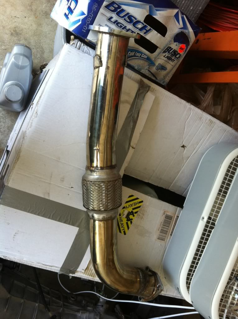

What I did with my rb25 into S13 for downpipe was stock O2 housing with Megan SR20 downpipe/test pipe and I cut the downpipe and turned it and had it welded. Just a "cheap" way to get it done.
Here's a picture of what it looks like when done. Notice the bottom part in the picture.

Are you using the Syko turbo elbow?
Stock SR downpipe should fit right up. It could only be for S14 however, just thought id give it a stab.
