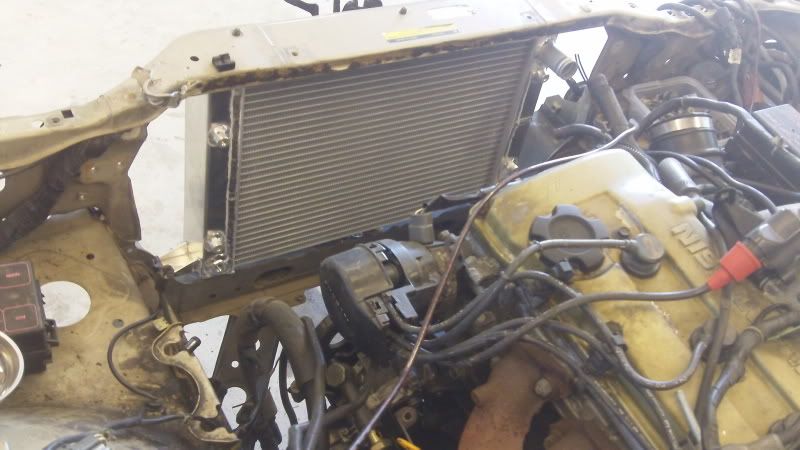

I've been staring at the core support for a while now. It looks like you can notch the lower crossmember of the core support. I am thinking about drilling out the upper support's spot welds and using M8 bolts to fasten it back on. I'll get up pics once my Flexalite fans come in.

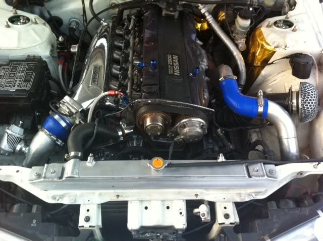

I have just the solution for you. You can do the pushers, however i didn't go this route and i too was faced with a situation similar to yours. Let me snap a pic for you. Mine is in the radio support.
EDIT: Here are some pics i just snapped of what mine looks like. Please excuse the dirtyness :P. Been working on her lately and no time to clean her off!

I like 2.5T_/<ouki's fix better than The chase bays one because it keeps the radiator at a higher point in the system.

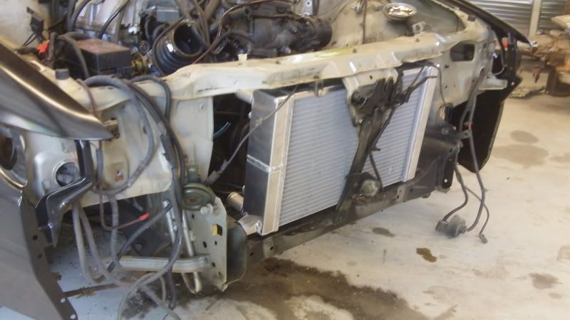

This is how I'm doing mine, from Summit for $250 or so.

^ Looks good, but is that sufficient enough for a 2J ?

I hope so, I'm putting in a LS1!

Fred, do you have the part number for that radiator? Looks perfect. I wonder if flexalite fans will mate up to that.

Originally Posted by Slo_240sx View Post
Gotta move this guy forward to fit some puller fans. Pushers aren't cutting it with a 4" intercooler and a 2.5 hot pipe behind it.
Holy shittttt.....
X2 on the "civic style radiator"
RB s13 out here making 500+ ran one
Honda powered s13
Here ya go, AFC-80107N from Summit. I think I'll have to run a surge tank to get it to bleed right, might get away with just putting a rad cap in the upper rad pipe but it's iffy.
