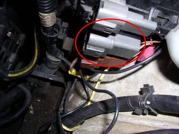

did you jump the park neutral switch wires when you did the manual swap?
Find the passenger side fuse box. If you look at it, it will have 4 plugs hanging off of it. 3 large plugs, and a small 2 wire plug (it’s not visible in the picture except by the two wires connected by the yellow splice).
The small 2 wire plug is the park neutral switch. To make the car start, you’ll have to jumper those. The easiest way is to cannibalize the plug off the AT tranny harness. Then you can just connect the two wires together with a splice and plug it back into the chassis plug.

I drove with the manual swap for a good 4-5 months, and the rb20 was running for the past week (just swapped it in after refreshing it). I played with the sensor unplugged it and plugged it back in and bam. Thing started and my key comes out... plug came loose.
