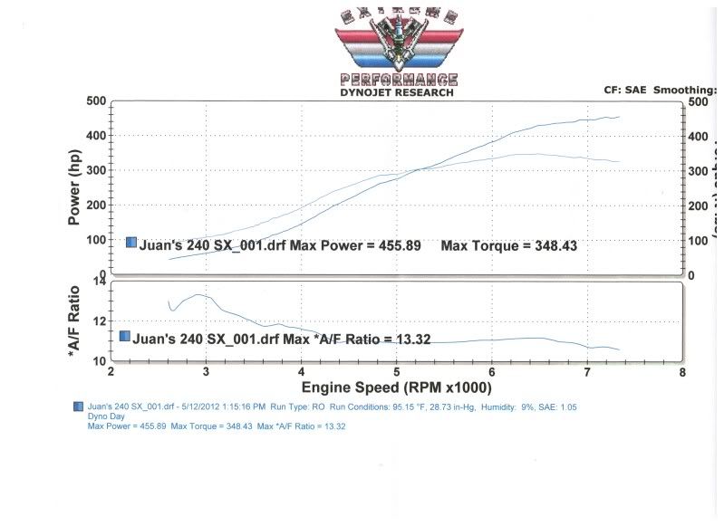

Motor is closed and running 20.6 psi of boost on E85, on a road tune, that was done for a previous built motor. This motor was supposed to be a temporary motor, however this has been my temporary motor for over 2 years.
I went to a dyno day recently and it turned out my car made 455 almost 456 rwhp and almost 350 lb-ft. Seeing how I been at this power level for some time, And how fuel richens up a bit after 7,000 rpm I think there is room for more power if fuel leans just a bit up top, and perhaps find if timing is ideal or if it can be advanced even more.
I wonder has anyone done 500 rwhp or over in stock headgasket and bolts? I know for sure of one car with over 450 in my personal experience this has turned out to be reliable. But I can't help but feel that I may be pushing my luck, if I go further.

Well that is not very comforting, I am running a 15 year old head gasket and studs, and I want to retune it. I don't want to turn the boost up, but I want to advance timing some more (running only 25-27 degrees so far.) And lean it up to 12:1 ratio. And ok maybe 1 psi more couldn't hurt.
As it stands right now.

your roughly where i would keep it. ive seen complete stock motors on C16 make 460 and with E85 running cooler it will help but your around the range where its a flip of the coin. I lifted my head with a T76@28psi wit ARp's but now on a 6266@33psi and zero lift. it seen 35-40psi spikes too and all checked out. i wouldnt go any leaner and timing same thing. im on forged pistons and i have more timing but i wouldnt push the stockers any more then that
