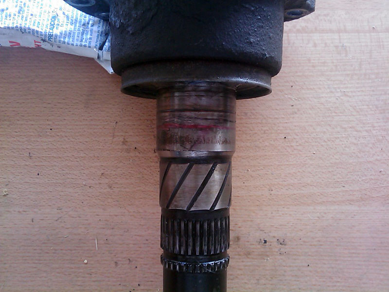

It's either A) hitting the c-clip inside the differential or B) you installed a VLSD into an open differential pumpkin and the longer shaft is hitting the open differential housing.
If option B) you will need to shave down the shaft like so...
From the red line down needs to match the shaft diameter and the black line above it (about 3mm up) needs to be tapered up in the same manner as the original taper of the shaft.
Good luck.

so after waiting and being frustrated i went back to try again and it still wont go all the way in it does stop at that red line but its not a open diff pumpkin i got it off a n/a 300zx
