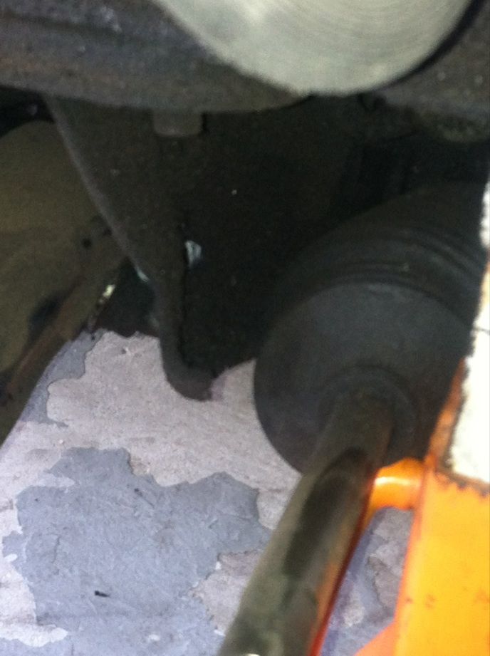

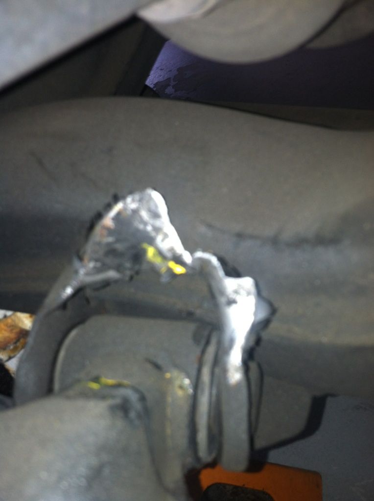

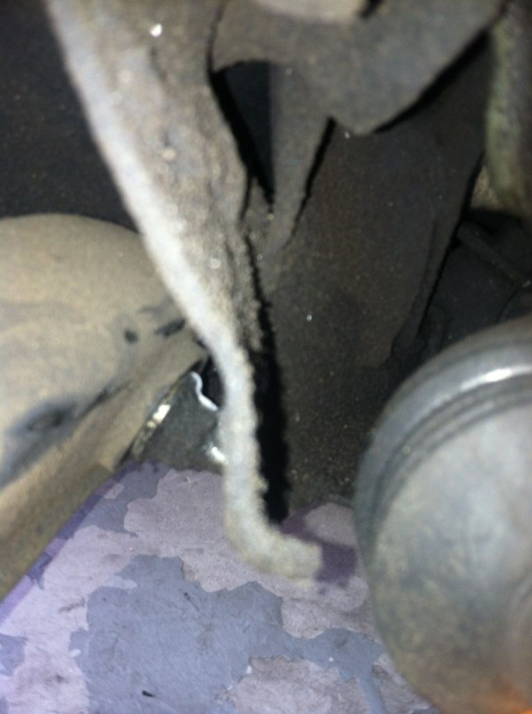

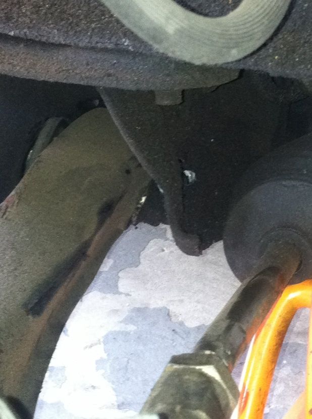

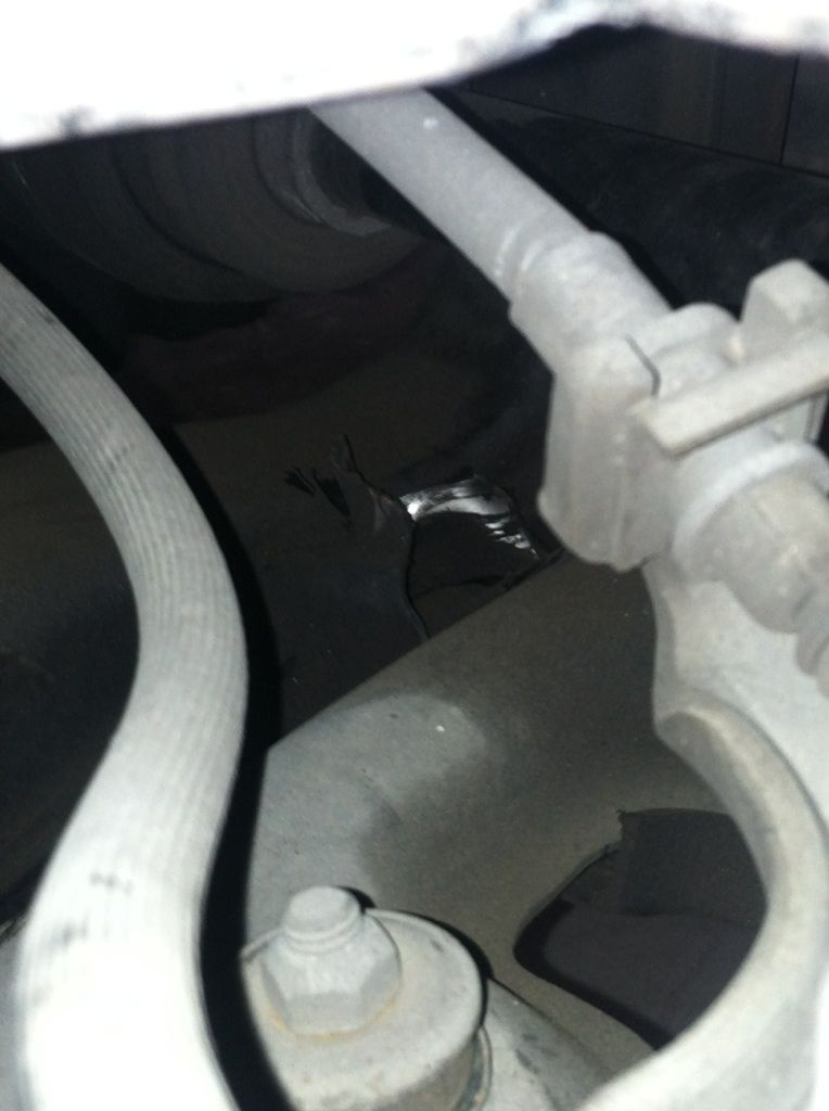

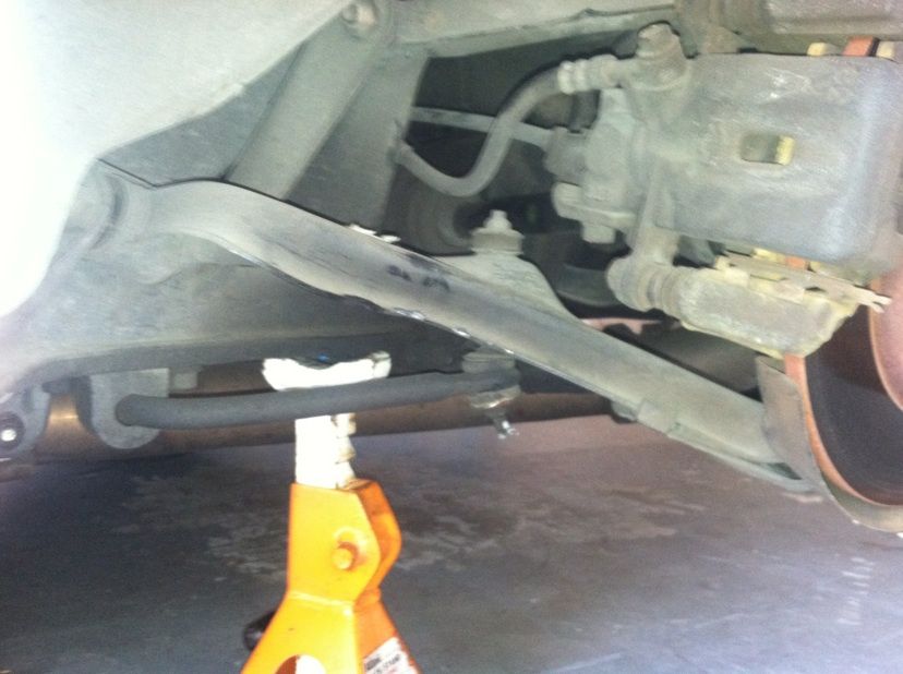

do i need a new subframe or is this fixable??
whats up everyone so got in a little accident and dont know if i need a new subframe for the rear maybe also the front to wondering if anyone can check out these pictures and let me know what they think
REAR:
FRONT:
Sorry for the shitty picture quality off my iphone
The rear LCA is wrecked i know but thats why im wondering if i need a new subframe before i fix that along with the front is the same. Thanks for the help guy lmk if you need any more pictures or information to provid a better answer for me

front x-member is toast. what the shit did you smash into/over?
Originally Posted by DJ-of-E View Post
Prob hit a curb real hard.
Ya hit a curb tandeming at like 40-45 almost flipped my car then my friend tandeming hit me... wasnt really a good night
but on another note everyone was alright and my car took the most damage but what do you guys think new subframe or can it be fixed??
SoCalDrifter is offline   Reply With Quote

I'd suggest getting a new subframe...
btw, I have an s13 subframe just chillin in my back yard if you want
just throw me an offer.

replace both, and all arms on that side. probably knuckles too.

Replace front and back they are both done for, if you don't have plans to be going into any amateur or pro drift circuit the S14 sub has better geometry then the S13, not all of your S13 parts would go, if you have RUCA they are interchangeable and your coilovers will still be S13. There might be others but I cant remember. Its hard to tell in the pictures but it doesn't look like you have any aftermarket suspension back there.
