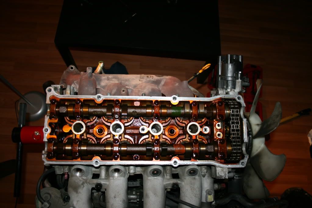

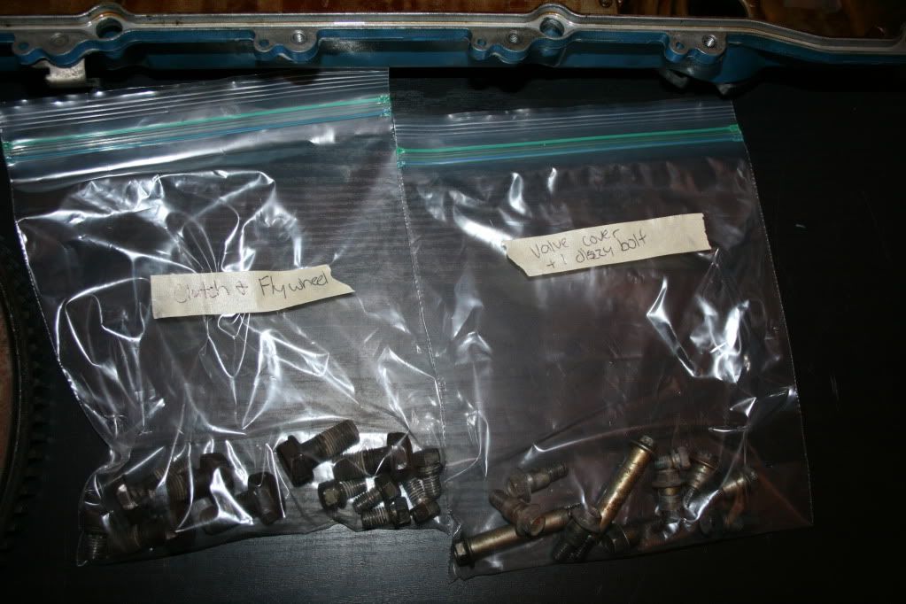

Pulled off the valve cover. Looks good nothing milky ^.^
How I am organizing everything
