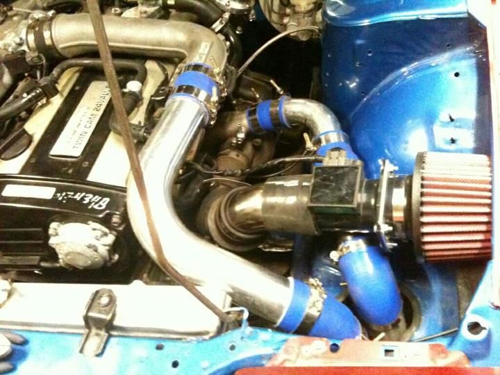

Here is a picture of the intake fitment under the bay. As you can see, its right under the fender so water can leak down over the hood, into the bay and on top of the intake. I have now got another intake and fixed that so that shouldn't happen anymore. But my car is still running like shit.

have you acted on any of those ideas you had? i.e: did you pull the plugs to check if they are fouled?

Idles until it gets warm, then dies? and it sounds like it is running on 4 cylinders?
Could be that you screwed up your maf, plugs and O2 sensor. The O2 and plugs would be from the extra fuel, the maf from H2O.
I am just guessing though, it has been a while since I helped troubleshoot car problems over the internet.

well see the thing is if the maf was messed up wouldnt it not rev above 3k? it revs well above 3k. ill spray some cleaner on it, and change the plugs. See if that helps.

Back to running normal. all my power is back as well. Cleaned the maf, changed the plugs.

Maf had a good bit of dirt built up around it. Ecu probably freaked out and dumped all sorts of fuel. Which flooded it and wouldn't start. And smelled like gas until i let it sit overnight. Got myself a new intake so water doesn't get on it.
