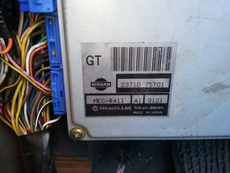

been having trouble with my car. it has a series 2 rb25det with greddy plenum, q45 throttle body, full race exhaust manifold, and garrett turbo. (stock maf and injectors) anyway. it drives fine but smells pig rich and cant run o2 sensor. when i connect it, it fouls out my plugs almost instantly. i was told i may have the wrong ecu... im hoping someone here can identify it. when i type in the numbers its all in russian and all i seem to find is that its from a nissan laurel. thanks in advance!!

Weird, FAST system doesnt recognize this Part Number

Yea it's weird, I found something that said it's for an RB25DE, but it's in another language.

I believe that's a Euro C34 RB25DE ECU or some mash up that's not often seen, when I ran the numbers the first time it came up with CA16DE.
Your looking for this guy here.
R33 GTS25t RB25DET Series 2 Manual RWD 23710 13U01 MEC-R721 A1 7207 (#G8)

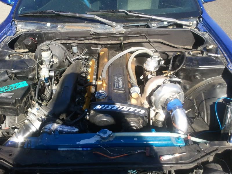

ok. so i ordered the mines ecu anyway and decided to give it a try, and if it didnt work return it! tried just direct ecu swap.....nothing! Then thought it might be tuned for z32 maf, so tried that....still nothing! but it will fire up with no maf connected at all, just wont rev past 3k. Is there any other maf possibilities they might have used to tune that mines xprom??
this is my current setup

I think your asking for trouble with using that mines ecu at all. No one really has any idea on what its tuned for. You are going to have problems, for example, a lot of those tuner ecus from Japan are tuned for 98-100 octane gas. Also who knows what injectors that thing is programmed for either. Just get a stock ecu to get your self on the road. You could of been driving this thing already!
Also, fyi, your catch can/pcv system is fucked, you are going to suck in un-metered air when the pcv valve is open and the valve covers will never see vacuum. If you are going to use that system get rid of the filter vent and connect it to the intake between the turbo and the maf.

Like the others have said, who knows what its tuned for. Return it while you can. Save a lil more and atleast get powerfc or 300zx ecu with nistune. Then you can input proper injector size and maf. Not to mention get a tune that matches the airflow requirements of your setup. That intake kills velocity which means low end torque, so does that throttle body. Thats probably why so rich down low. Then once that turbo spools you wont have enough fuel to even use it much above 7 psi. And the timing will be off too.
Bottom line get a proper ecu/tune, dont bandaid over something like brain surgery.
