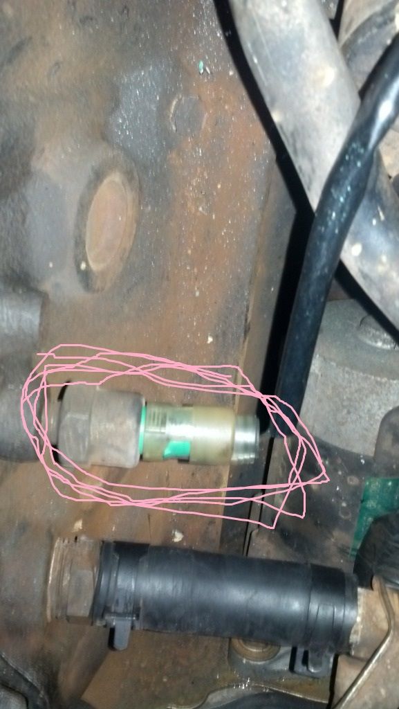

like the title says i kinda stepped on this piece and it broke not sher if i even need it or something heres some pics maybe you guys know what this shim digger is
heres where one of the lines plug in under the intake mani

What part are we suppose to be looking at? The green sensor the is attached to the block is your Knock sensor. What else were you referring to? Point it out with MSPaint

this is the one towards the rear of the block that is still together and the on toward the front has broken looked pretty rotted

yea your right bro its my knock sensor i guesss i should buy another one or is it ok to just rock 1

I would not recommend running one knock sensor.

Run BOTH!!! Cannot stress this enough. I know part of my RB25 going out was due to the idiot who did the harness conversion/install never wiring in one. Part of that was my own fault for not learning more about the wiring and checking his work.
