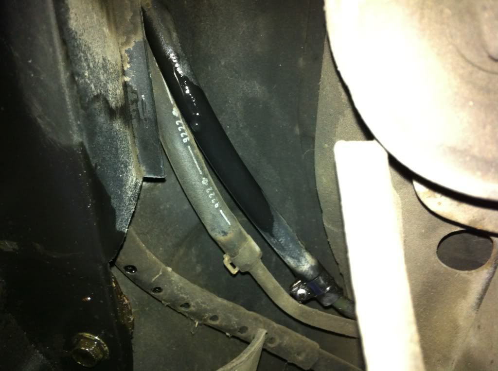

I have a 89 hatch that's leaking on the return rubber fuel line near the gas tank passenger side. Most possibly because its dried and cracked. Is it possible to replace line without dropping the tank and what size hose is needed to replace? If the line is a return and leaks only when the car is running, am I expected to have what is in the tank to pour out until empty?
Here's a picture: http://i1299.photobucket.com/albums/...ps2c468a8c.jpg

Those are easy to replace, just remoce fuel pump cover. And u will see the hoses just remember not to mix up the lines when u remove them. take the hose to a auto parts store they will help u u will need some long neddle nose pliers with a 90degree bend at the end. 15 min job

^^ what he said.... and if you did need to remove it, it is not even a 10min job to drop the tank on an s13....... s14 is another story...

The size hose you need is 5/16"

What everyone said. Easy job, except sometimes those old hoses SUCK to remove
