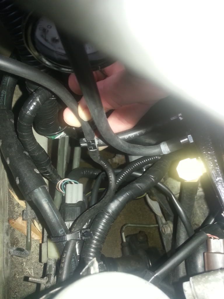

From this point, you will run the vacuum line(so the gauge reads boost) and the power cable(solenoid wires) thru the firewall. I passed them thru a small slice in the engine harness grommet. The two wire(black and red) that go to the solenoid will be soldered in to the two brown wires. It doesn't matter which order, just solder them to ensure a good reliable connection.
The previous owner of the intake manifold sealed up one of the holes so I had to use a T off of the bov line for the gauge.

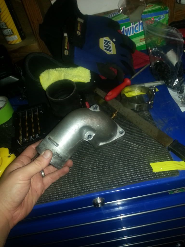

The only issue here is our factory turbo does not come with a fitting to get turbine pressure and the less hose the better. This is why I removed the cold side elbow and installed one. It is very easy and the fitting comes with the kit.
Remove the elbow from the intercooler piping and the turbo.

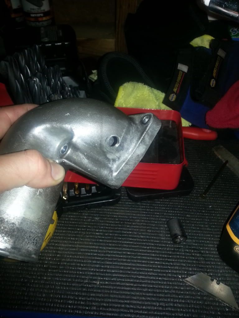

After that is removed, drill the hole to match the fitting. I used a small bit at first when I decided on a location and stepped it up until it was the right size.
I then used my dremel to get rid of the metal spurs caused from the drill. Once the fitting is installed, I re-installed the elbow and was now ready to measure the hose lengths to the solenoid.
