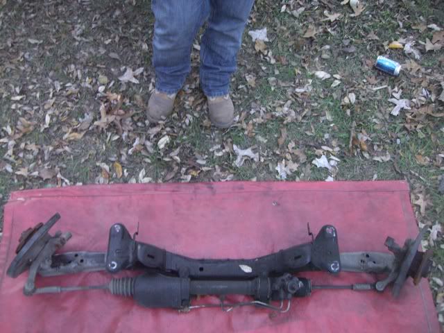

No SOHC lines will not fit a RHD rack because well, its RHD, might be able to bend them into place but you risk breaking them again. Find out what connectors you need and get some hard line and a pipe flaring tool and make your own. Driving a PS rack with no PS can cause them to wear out prematurely.

So I was told my steering rack has to be a RHD rack or else I wouldn't be able to steer at all. And since it was pretty hard to tell the difference for me at least.
Now I just need to find RHD power steering hard lines
