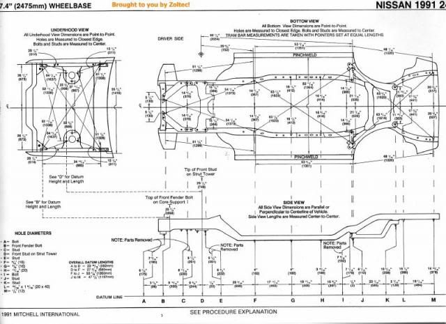

I'm looking for anyone that can get the distance from the rad to the engine crossmember, and engine xmember to 5 speed trans x member. I'm doing a custom install and don't have a motor and trans yet, but want to get things roughed in.
So any help will be very appreciated, thanks.

All of the chassis dimensions are at the end of the body section of the FSM. You might be able to use certain dimensions shown in the diagrams as a reference to get the dimensions you're looking for.

Thanks very much, I never would have thought to check the FSM for that. Then I also came across another diagram that is a little easier to read as well.
