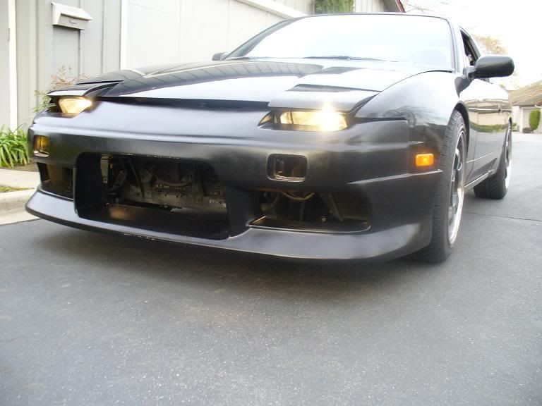

Do the brown wire. Saves alot of time
sleepy eyes doesnt look that bad heres my car.
Touke <3
