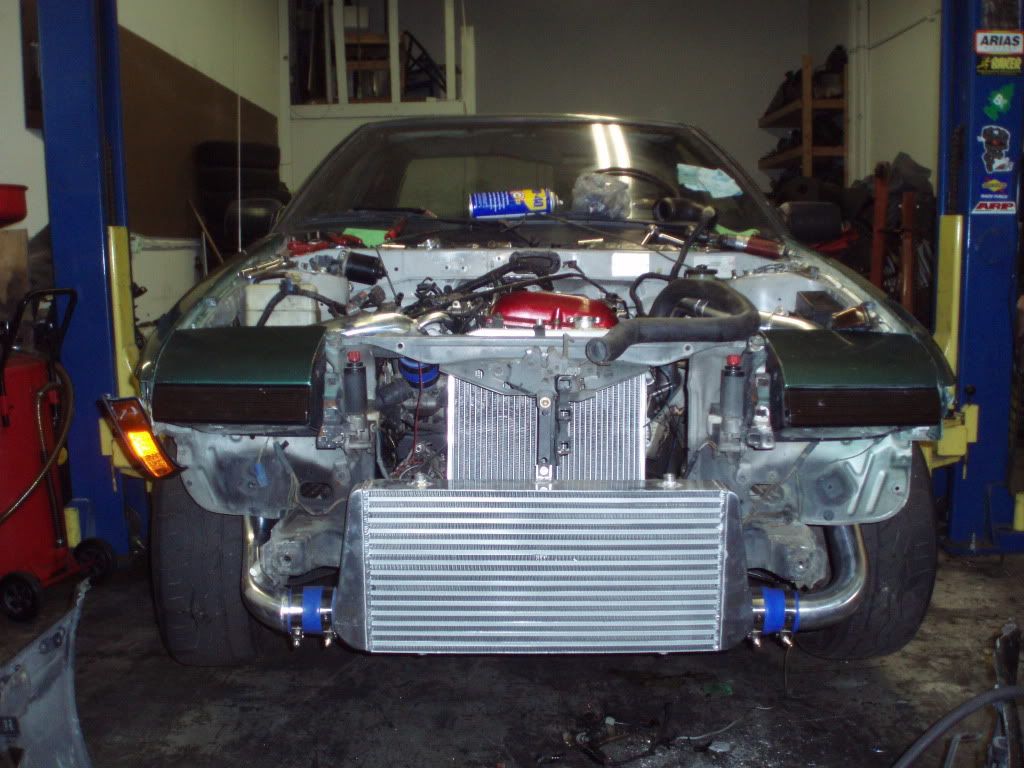

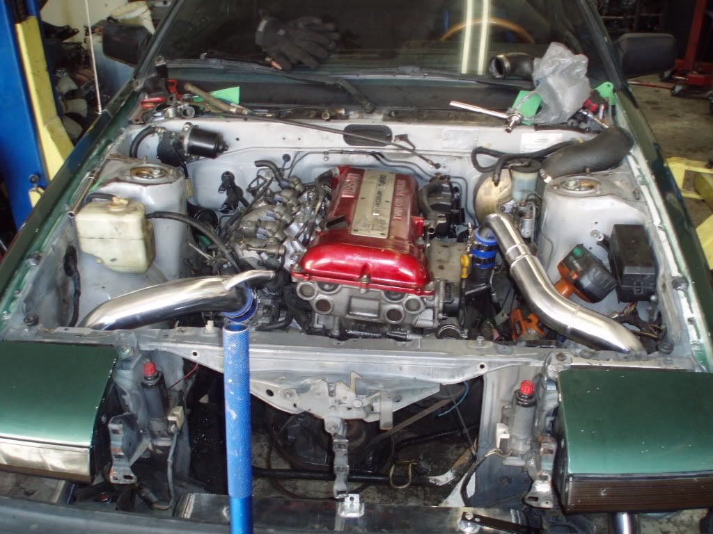

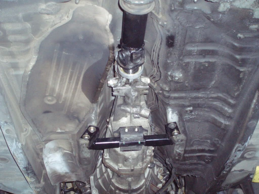

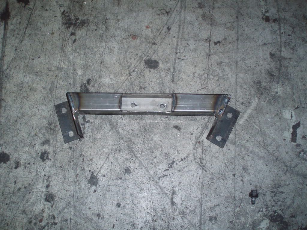

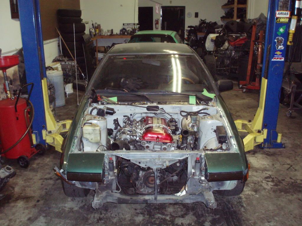

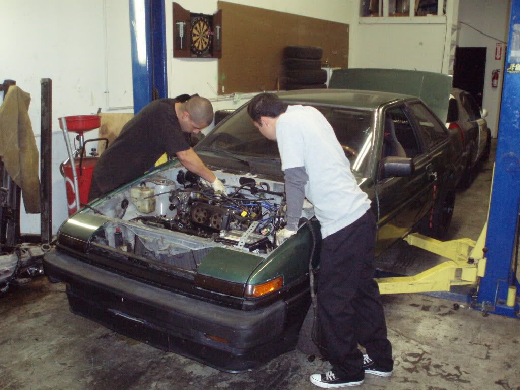

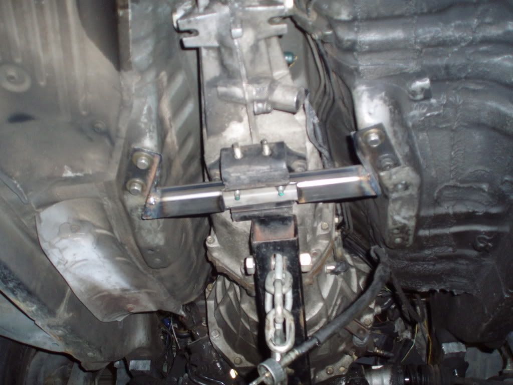

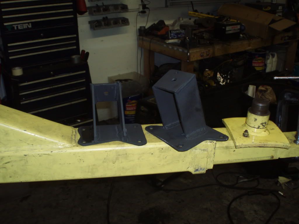

Finally got a chance to do one of these swaps enjoy.

JSP fab subframe risers by chance?
Looks like a clean swap. I've done two of them myself.

Give me some specs, What intercooler kit did ya use and whered ya get it from?
WIRING!!!
Document and Post it up please!!!
What did you do about the speedo?

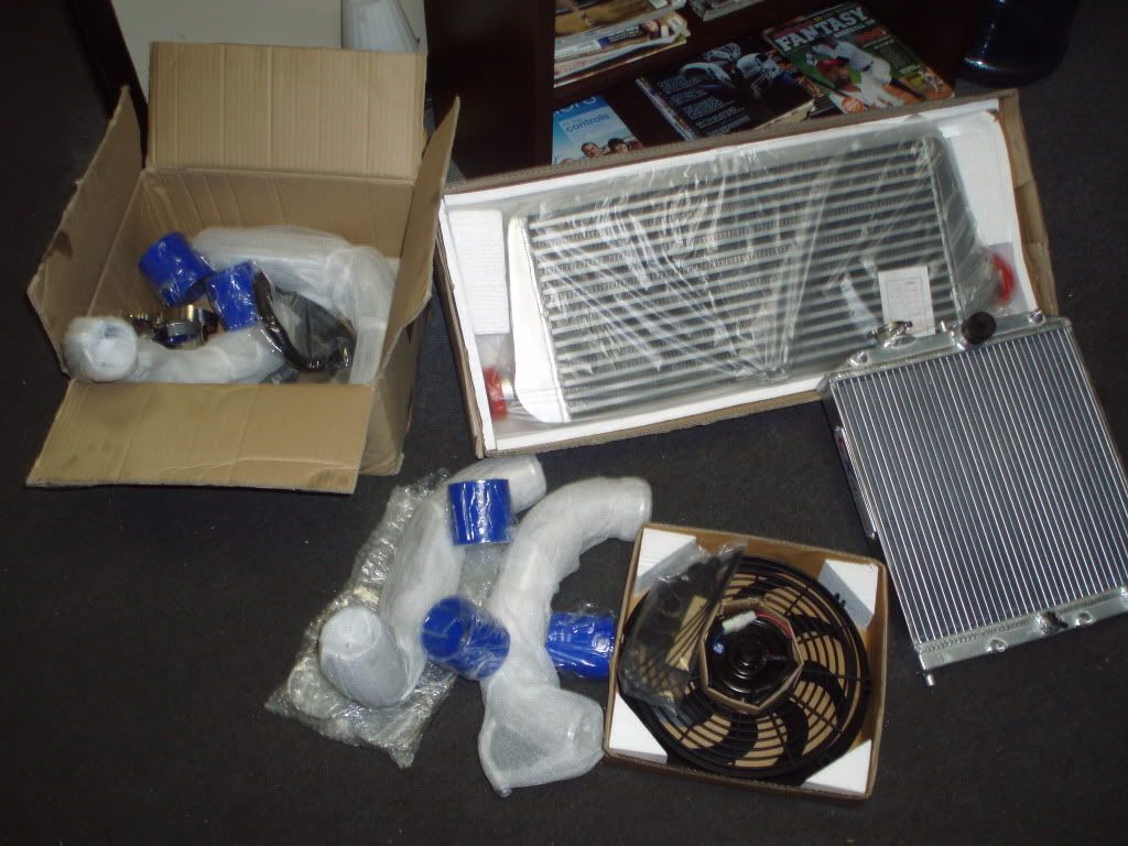

It looks like he's running CXracing intercooler kit

The Front mount intercooler and piping is from cxracing. You can use any aftermarket s13 front mount intercooler and piping. The mounts are design so that it clears everything except for the stockcollector (aka, dump pipe, elbow). You will have to make a custom collector. Its really not that hard. You can also reuse the stock radiator or an aftermarket one for the ae86. We use the honda b-series radiator tho. We check the clearance and the stock radiator fits but you will have to reroute the upper radiator hose. As for the speedo, i remembering reading something about using older year cable speed sensor form a supra but not sure. As for the wiring its really not that hard. There's a lot of how to wiring on this forum. Once i find it, ill post it up for you.
yup your right....
no we made everything in house and its now for sale at our website.
Sweet I got an extra in storage ^_^
Yeah I got custom mounts already for it and read about the elbow needing to be modded.
Rads not a problem I got a Stock SR one and will make custom mounts for it.
Older toyota huh? I read about some ppl saying the older Datsun from a speciffic year Z31 or S30 model I think.
Wiring is my main concern, Ive read a bunch of threads on 4AGE.org but nobody posted specifics.
I owned a 83 Levin 4 years ago but haven't messed with one in a long time so i forgot all about the wiring in that chassis
If ya can man thanks!
PS. was that originally a SR5 Chassis? I ask cuz it looks like an external Fuel pump next to the Fuel filter in the engine bay
Yea the car was originally SR5 and someone converted to GTS.

this is all you need to get the sr20det running. Just refer to the ae86 wiring and tie it in.
