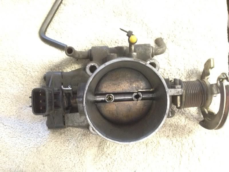

Something like this happened to a buddy of mine not too long ago.
One of the bolts on the butterfly in the throttle body got sucked into a cylinder and was actually what was smashing the spark plugs.
Pull ur coupler off and see if your missing a bolt
He pulled out the bolt before any major damage was done,..and motor is still running strong
This is it, The butterfly bolts have snapped and you ingested one. I ruined my first SR this way im pretty sure.

Thanks for the responses guys. Literally just put the motor back in last night after replacing the bearings. I thought the noise was knock at first....haha. Compression was a solid 150. Definitely will check the TB, I've heard of that happening before. I'm about to start pulling the head and ill post up my results
