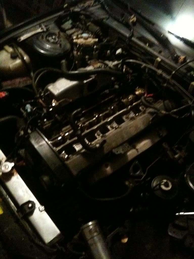

I have a series 2 in the s13. It's completely stock except for a few basic mods: godspeed FMIC kit, spec clutch disc, full 3 in exhaust (no cat), and walbro fuel pump. I put a manual boost controller that I got from ebay for $12 and set the boost to 10psi. It pulls hard sometimes and sometimes it doesn't. Tonight for instance, I down shifted to 3rd going 60mph on the highway to feel the pull, when it hit 6k rmp it started to back fire and sputtering then after that, it did not pull whatsoever. When I got home, I popped the hood and saw a glowing red turbo and the exhaust manifold. I am guessing it's running lean... I know for a fact that it's got a dirty airfilter but i don't think it has anything to do with it. There is no vacuum leak or boost leak. It has the sparks plugs (platinum) for 300zx tt. I am going to check the gaps on them tomorrow, change the fuel filter as well as the airfilter. If neither works then I am going to have to look at the timing. Any suggestions will be appreciated.

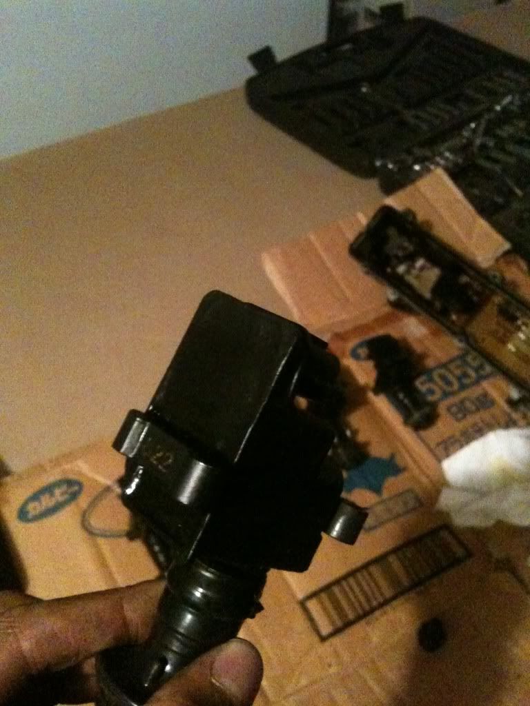

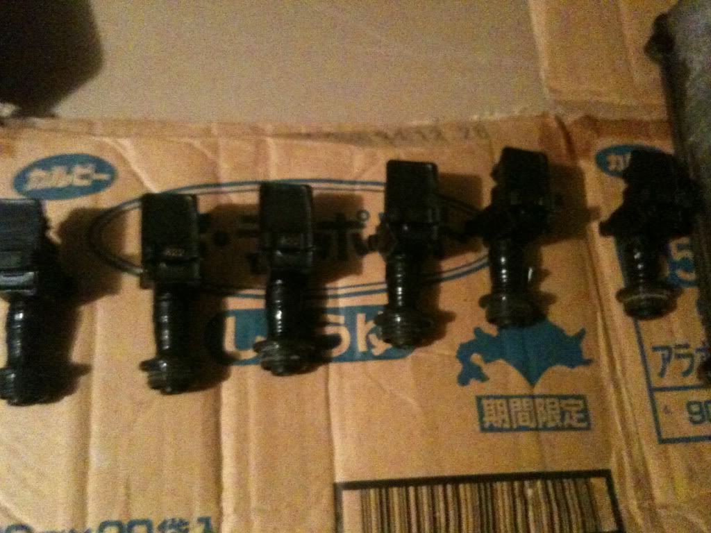

Neejay, no it doesn't skip like that. It just runs like crap at WOT, full boost (7psi). I can hear the engine screaming wanting to go but it's not going anywhere, the RMP is not rising like it's supposed to.
I think Chuy is right, I am in process of insulating the coilpacks at the moment hoping that it's not too late. A bottle of liquid tape for $5 at walmart, not bad. Well, It's 4am in the morning here in TX but thank god we're still off for the break. I am going to put this puzzle together and let yall know the result. By the way, one of the nuts on the turbo exhaust housing was loose, could it be the culprit?

make sure each coil pack is actually touching the tip of each plug, and like the previous poster, insulate and make sure they are not losing spark before getting to the plug somehow. Make sure the plugs have the end tips that work with JDM cars, some of the plus in us have shorter reach and dont make good contact with the inside of the coil packs, as they were dsigned with OEM in mind, with distributors in many plug situations...happens with RB and VG plugs a lot. Make sure the grounds for the coil pack system are also good and all the wiring is in great shape, 90% of quirky issues on these damn cars with basically stock swap setups is crap wiring from crap motorsets to begin with....

steveshadows, thanks for your advice. I just got some LS2 coilpacks from some guy off of craigslist for $150 for all 8 (off of a 2006 silverado) but still NO LUCK!!! I wired up everything correctly, properly soldered, and insulated. My dad did helped me out too since he's an electrician so I can assure that the wiring is done right. After driving the car for about 20mins, I popped the hood in the dark and saw the plug wires arcing to the head and also saw #5 and #6 coilpacks with minimal arcing inside. So I thought the plug wires were bad so I went ahead and dropped $40 for Accel plug wires but still nothing, instead, it feels like redlining a gsxr or cbr around 4k+ rmp (yes, harcore sputter). Sometimes when I slowly rolled on the throttle, it climbed through the rmp fine and made power but it was not consistent. I am tired of all this, it all happened when I decided to put on that stupid boost controller which was set to only 10psi!! It ran fine for a day or two then it started to lose power at high rmps. At this point, I really want my beastly RB back.
I am running out of solutions but obviously the wire plugs or coilpacks are not supposed to be arcing even if they're hard to notice. When I installed the LS2 coils, I did a sloppy job at the end; I just connected the plug wires to the coilpacks and that was it, yes, I did not mount them to anything, I just had them set on the head, and now after purchasing the Accel plug wires they're sitting on at the side where power steering is. My question is, do the coilpacks themselves need to be grounded even though it has two ground wires (one for the original harness ground and one for the chassis ground)?? Also, can the plug wires touch anything like the head or even each other? Any help will be appreciated. I will take a pic of my shameful work tomorrow.
