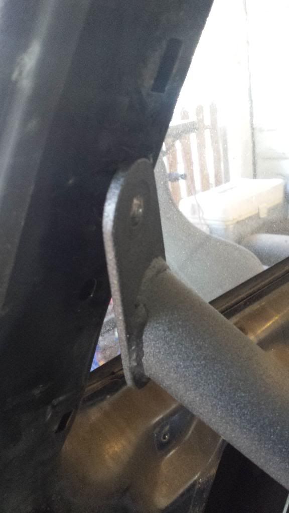

i put the bar where the bars holding the hanresses as straight up as i could and took this pic. i could maybe get the holes line up with force but theres still a large gap behind it

It's either the wrong bar, or you're putting it in the wrong spot. Those Harness hopes (to keep the harnesses in the right spot on the bar) need to be just like the other picture.

it seems ive tried to fit it every way and the first pic is the only way to make it sit flush so im not sure what else to try. i pm'd mazworx a link to the thread. hopefully they can chime in or get back to me

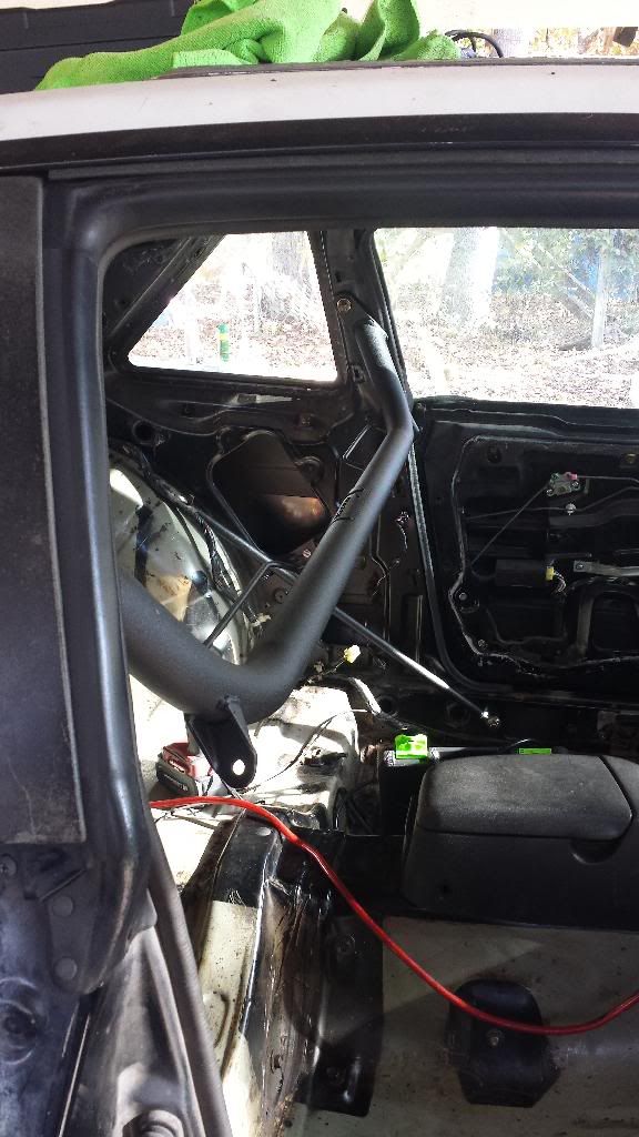

Got it installed. The bar was backwards and the hoops for the harnesses do not aim straight up like the pics.

Can you take pics of it installed? It just seems a little wonky for the strap limiters to be upside down, I've *never* seeen that.
They aren't upside down. They almost stick straight out towards the front of the car. Its strange to me too but it works lol.

heres a pic i snapped after the install.

Take a picture of the mounting points. I would call a Mazworx and have a discussion with them about it. They aren't suppose to be like that.
