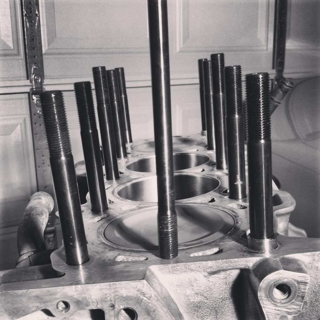

After trying to clean out my block multiple times to get the studs in evenly and many failed attempts I get them pretty close so I figured it should be ok
I get the head on and begin torquing the nuts done, 20lbs went fine, then on 40 lbs I started on the center one and it started getting tight and then all the sudden started free spinning. I turned it a couple more times to see if anything happened and nothing, so I put and allen head in and took the stud out.
This metal shaving was twirled all in the threads..
Now I tried putting the stud back in and it seems to thread in fine but I don't know what to do. Any experience? I paid a lot to have this block refinished it's going to really suck if the stud holes are toast or should I rethread it back in and try again?
arp btw

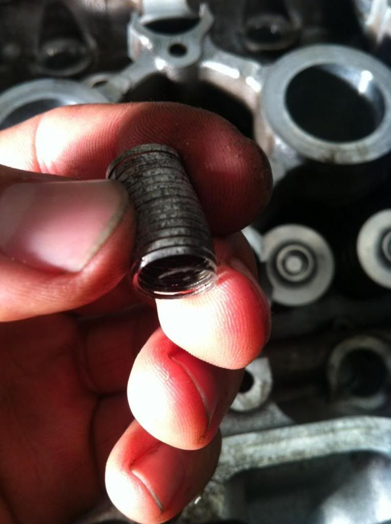

I had this happen to me a few months ago.
DO NOT HELICOIL. Either buy a thread-sert kit for a B series honda and use the spacer provided for a B16 or take it to a machine shop to do it.
I make over 400 WHP BTW. My friend had this happen on his car also, he did the same thing and he made 875 WHP.

TIME-SERT, Keensert, Keysert, Acme Threaded Inserts are all better than Heli-Coil's.

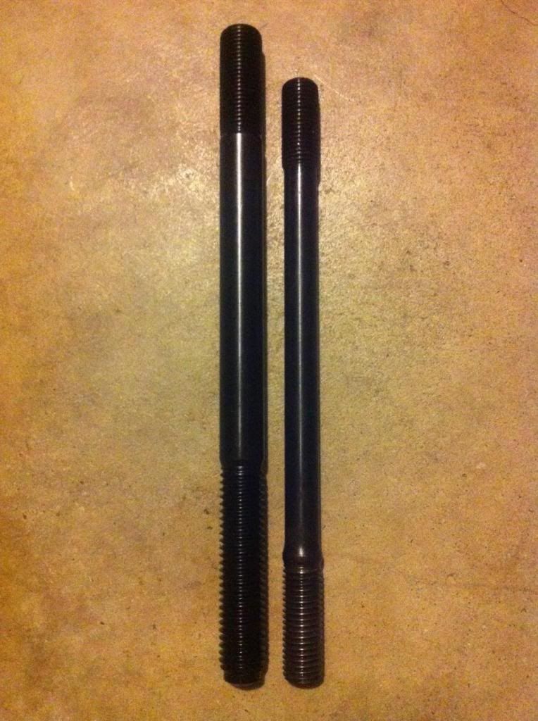

Just for those who haven't seen here is a comparison of the ARP Sr20 studs vs the Mazworx 1/2"

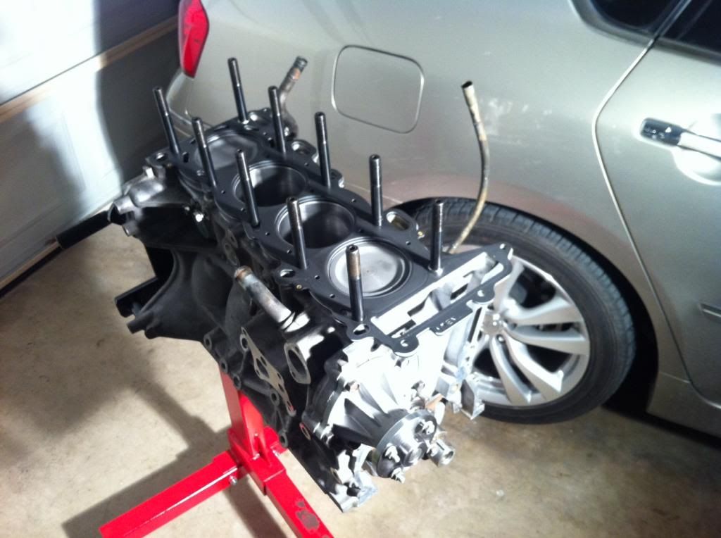

Just an update/insight for future readers who may do the same.
Labor cost $250 to drill/tap/and fit the headgasket. I used a Apexi HG and the only 2 holes that needed to be drill larger were the 2 for the new larger dowels.
Torque spec on these is 65/85/95 although I went 20/40/60/80/90/95.
Few pics for comparison of size.
