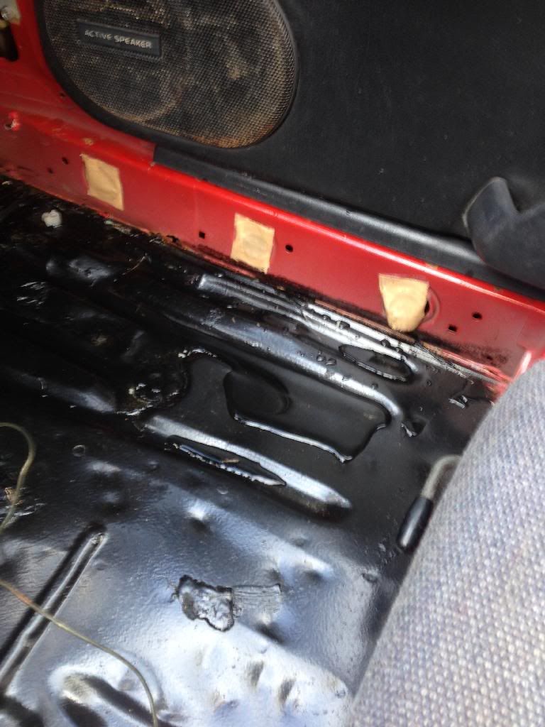

Whatsup eveyone,

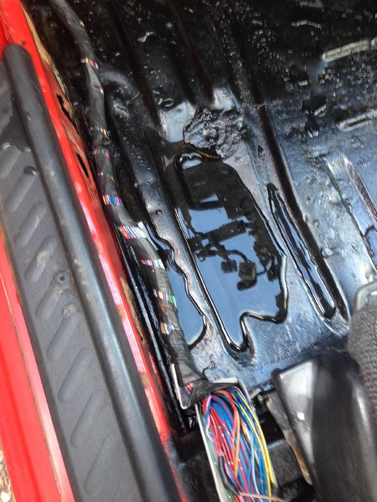

I have a nagging issue with my S13. Upon my return to the car I opened my driver's side door to find a pool of water that was in this location:
I also have this issue on the other side as well. There is also water where the passenger footwell curves upward to the firewall. All AC components are installed.
http://i1064.photobucket.com/albums/...ps9ukcyltl.jpg
Now for some extra information. Yes, the windshield is old and the seals are old. The driver's side mirror rubber is old. The door weatherstripping on both sides are new. The sunroof does not leak. The headliner is not wet in any area. Occasionally I will walk out to the car and there is condensation on the inside of the windshield.
What could be the culprit? Is there a hole under the dash I've missed? Or, rather should I go about replacing the mirror rubber and the windshield components.
Thanks everyone in advance.

Alright everyone so I did some super sleuthing today outside. On the passenger side it looks like it's coming down in between the door and the interior door panel?? What is this witchcraft?
On the driver's side as I open the door it looks like there's water dripping out towards the front of the door. But, at the same time there's water droplet residue on the side of the dash that's adjacent to the door panel.
I'll check the sunroof drainage again.
This is infuriating. I just want to install my sound deadening and carpet already.
Thanks everyone for your continued help.
