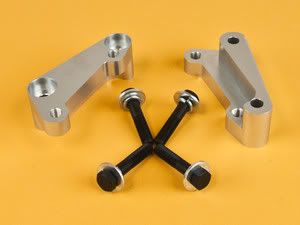

I bought the wrong adapters for my car. Have a 240sx and got the 300zx 350z rotor adapter. Will it work? I notice there is a slight difference on the adapters. Any reason why?

Originally Posted by future View Post
No shit. They are the same we said it twice
What i got. Says 300zx
This one says 240sx
See the difference? Occording to that they are not the same. Is a legit question.
This one says 240sx
Mounting points are obviously different.

Thanks booey, seems the sent me the wrong ones. S chasis and z do need this adapters to run the 350z 12.75 " rotors but was confused after looking at this pictures

Found this on concept Z. Looks just like the 240sx adapters. Maybe it's because those pics are from ebay?
CZP 300ZX 12.75inch Upgrade Adapter Kit, w/ 350Z Track Rotors - Nissan performance parts

Yeah logic says that but those are obiously different adapters. Do u get me? They sent me the one that looks in a angle. No idea Why they made them different to the standard one. Who knows all i know is i have to send them back and get the correct ones.

They are different because the mounting points on the knuckles are thicker on the Z32 than the 240sx.
