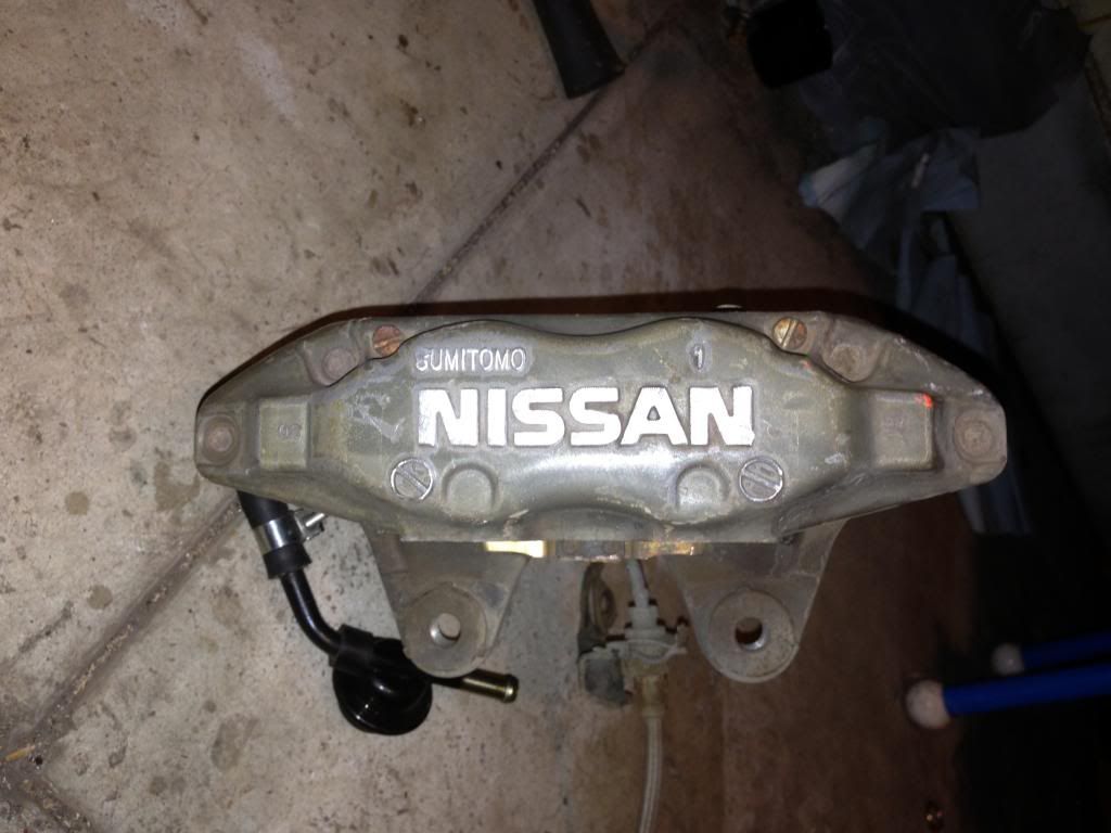

Is my front calipers 300zx or R32 calipers?
I have these black calipers on my S14. They're the same as the 1st pic. I wanna know if they're 300zx calipers or R32. And if they're 300zx calipers, what's the difference between the ones i have and the 300zx with the fins on the caliper(2nd pic).Attachment 70165
Attachment 70166

I think r32 and 300zx calipers are basically the same as they came in aluminium and iron. I also think they both have 26mm and 30mm options don't quote me.
The top caliper looks like my 30mm iron r32 calipers
The bottom caliper looks like aluminum. Can't tell if 300zx or r32 or size really

I also have the top ones(1st pic). I'm trying to buy project mu brakes pads, if I buy 300zx(z32) pads will they fit?

Definitely not R32 GTR calipers.

top ones are iron z32 Iron 30mm calipers.
bottom ones are z32 aluminum 26 or 30mm calipers.
^^^ these are r32 - 32mm aluminum calipers.

Top is z32 Iron
Bottom is z32 Aluminum
R32 rotors are 32mm thick, and z32 come 30mm and 26mm.

Incorrect. Those are R33 Gtst calipers.

was going to say the same thing. 100% sure those are R33's
I don't know if there is any way to tell the R32 and Z32 apart from the outside, but I do know for certain that they use the same rebuild kits but DO NOT use the same rotors. R32 GTR uses a 32mm front and the Z32 uses either the 26mm or the 30mm.
Also for some reason nearest I can tell the Z32, R32 GTR, and R33 GTS-T all use the same rear caliper. Though information on rear brakes is harder to find since most people get lazy and Don't bother messing with rear brakes.
Z32 30mm iron are the same as S14 Silvia fronts if that might help anything

30mm R32 and Z32 are the same
Z32 R32 R33 use the same rear caliper
These are BNR32 calipers

are those GTS-T's or GTR? never been able to remember which chassis code belings to which models of skylines

They come on all non v-spec r32 gtrs. The vspec comes with brembos

I know V-spec had Brembos but the non-V-specs should be using 296x32mm front rotors not 30mm. I don't know anything about what GTS-T's or sedans or GT-Fours use
Or do you mean the GTS-T uses the same calipers as the Z32-TT?

bnr32 = gt-r
