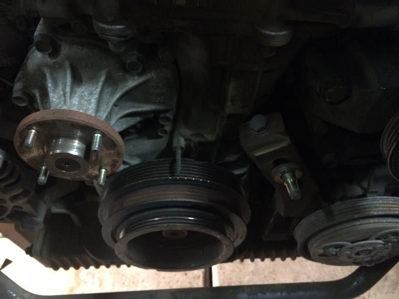

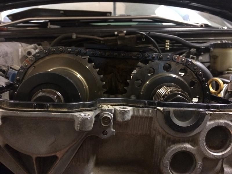

long story short, went to drifting event 2 weeks ago and drifted pretty hard. car spung out couple of times and engine stall. realizing a little lack of power, weak start up, but still pulls when turbo kicks in. drove home fine just feeling a 30% power lose. did compression test, 100psi on all four. (was done when engine is cool and forgot to WOT, but i shouldn't be that low). did some research and i m pretty sure the timing was jump that causes losing compression on all 4 cylinder and have same reading.
did some research, #1 cylinder at TDC by looking at the crank pulley, both in and ex cam line up with the dots on the sprockets and the silver mark on the chain.
question:
i m thinking it might jump a tooth in the crank sprocket. even tho the cam sprockets all lines up, i have no way to find out if the crank is line up with the chain unless i drop the oil pan, take off the oil bump and all those right?
from research, the two silver spots on the chain is just for initial installation. once the engine turns, it takes up to 60 turns at the crank before it lines up with the dots on both cam sprockets.
going out for dinner now and i think i can't escape from taking all those things apart. just wanna get more opinion from u guys see if i m going the right direction.
btw, its a s15 sr20det.
thanks

Its not possible to jump teeth at the crank, well not impossible but pretty far fetched. There's a finger that sticks out from the oil pump cover that secures the chain from popping off the crank. If that piece broke off, then it might be possible. But even then, you still have the tensioner keeping the chain from slacking and jumping teeth.
Drop a cap full of oil in each cylinder and re-do the compression test. If it jumps up to 150-160, its not a mechanical issue and points to your rings.

If you were off a tooth on the crank every time you rotated the engine over, that off link would have to jump again if you have the correct links from dot to dot. That is almost impossible from the clearance the chain has from the head on the intake side, if there was a 10mm groove cut by the chain and the oil pump guide/finger was broken then yes it could happen. When the chain jumps it's would be noticeable during manual rotation, and loud during running operation, and if the tensioner was doing it's job the valve would contact the pistons in no time at all.Why? The cams would eventually rotate out of time.
Set the engine to TDC and #1 cam lobes pointing out, count the links from dot to dot. 11 links
So let's hope that the impossible didn't happen.
Re-do your compression test, properly. And add a cap full of oil after you do the test properly then test each cylinder again.
Now if you choose to pull the pans, might as well schedule machine service, just in case, you only need a re-hone and new rings, worst case overbore and new pistons and rings.

i ending up didn't pull the oil pump but i rotated the crank like 40 times and got the mark line up. crank pully second mark from the left. both silver chain lines up with the in and ex cam sprockets. so i ending up putting everything back and re do compression test.

Mech timing looks good...if adding oil didnt bump the compression significantly, then its something else. Did you inspect all the rocker arms and make sure nothing is funky up there? Atleast can kinda rule out the rings, but like said already, now time for a leak down test to see where its leaking. Could be valves or HG. The valvetrain isnt noisy when it was running right?
