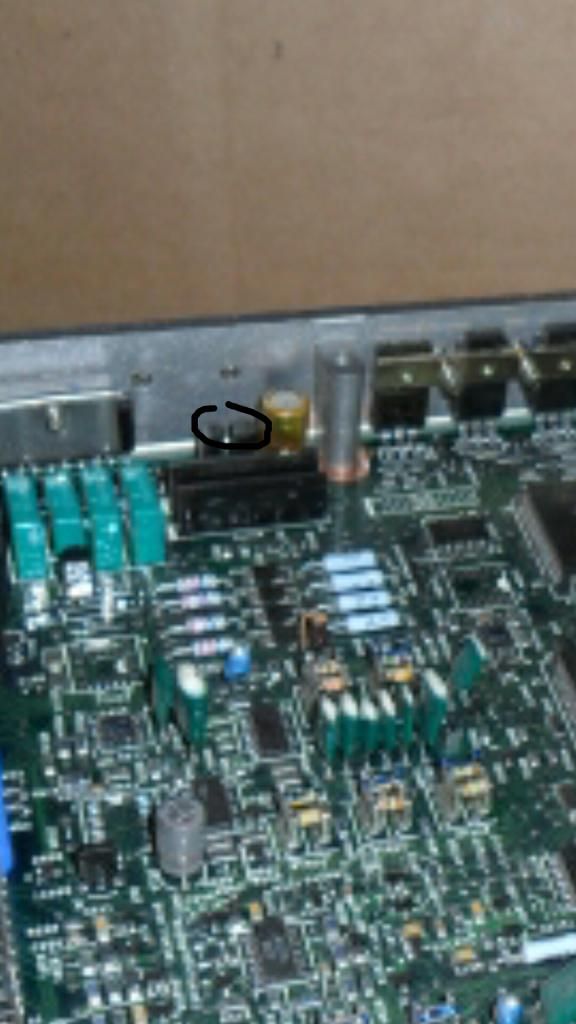

Yes sir there is no boost leaks whatsoever. But to my surprise I pulled apart the ecu and I noticed a burn mark. Looking directly down on the ecu with the plug facing you there is two little black boxes near a large gold resister that is fried is there a likely hood that this may be my issue. The ecu light goes off when the car starts and idles fine without the maf however I tested the maf and the voltage with the engine off is .8 v and when I blow through it I can get it to meter up to 2.2 to 3v. So I'm assuming the maf is fine. I'm lost. Wiring is correct and o2 looks new and wired apropriatley.......HELP! HAHAH

This circled here is burnt on my ecu

The two devices that you have circled are transistors, I believe they should be labeled Q455 and Q456, they are positioned next to the gold cylindrical capacitor C654. Unfortunately I don't have an ECU on hand that I can use to identify the engine system these parts are associated with, but it is certainly possible that failure of these components could cause the issues you are experiencing. From the symptoms it is reasonable to suspect that they may be associated with MAF or O2 sensor signal processing or IACV control. On a positive note, if the transistor part number or specifications can be determined it is very likely that replacement parts could be found. The size and shape of the transistor (designated TO92) is perhaps the most common transistor package, which makes locating replacements easier.
ps. Many of the components near these two transistors are associated with the fuel injectors, but it is also near the output pin for the IACV (Pin 113).

Thanks jakemkz,
I am assuming any circuitry failed could cause adverse effects elsewhere right?
I am just barely dipping into vehicle electronics and it seems like a monster in itself lol.
What does the average fix cost for something like that?

If it is just two blown transistors it could cost as little as a dollar or two for the parts, but of course replacing them requires a moderate level of soldering skills. The one concern that I have is that these transistors probably didn't let go out of the blue and their failure may have been caused by a wiring fault. Before plugging in your new ECU I would suggest going over the wiring to check for shorts. If you can trace the blown parts to an ECU pin it will narrow down the amount of wiring to be inspected immensely. Vehicle electronics is indeed an intimidating field, and it only gets more complicated with modern cars, the Bosch ECUs I work with have a 6000 page manual and well over 10000 variables.

Update guys!
Repinned an j4 ecu for my harness (what it should have been all along) and the car still has all the same issues. Does idle much better in loop than it did before. For what thats worth. And I have hawk eyed the while sphagetti loom and all is well. Am I just getting bad mafs??

Have you checked your timing? Also have you confirmed that your c.a.s. is stabbed correctly? If your c.a.s. is stabbed even a tooth off your car with run like shit and your idle will be off. I had this problem with my car when I first got it and it took me a long time to track down.
