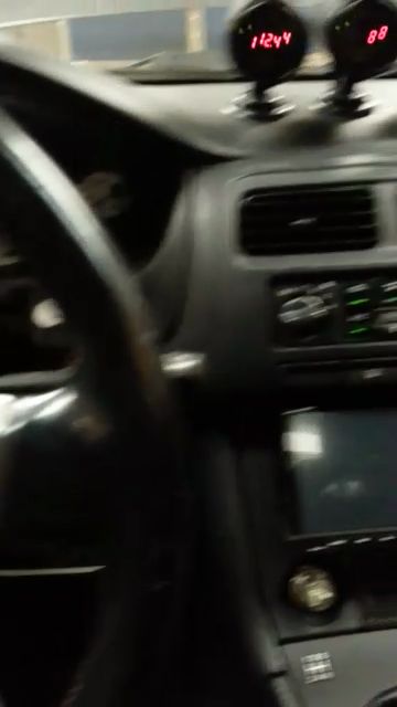

How Cold does your A/C get? *** RB26DETT S14***
Well I got my A/C up and rolling and put a video together for vent temps, before I did this video, my temps were at 39 degrees to 44 degree's but then it heat cycled a couple more times then I took the video. I'm using the GTR compressor with modified S14 to R32 A/C low side hose and S14 high side hose. R134a with a little bit of PAG 46 oil. I kinda regret not changing out with a new condensor and dryer but it's pretty darn cold for now and I just wanted to get a general consensus of what temps you guys see with a similar set-up? Oh and I checked my temperature in my garage it was 95 degrees.
