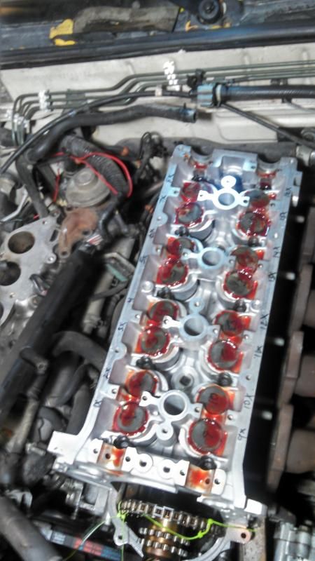

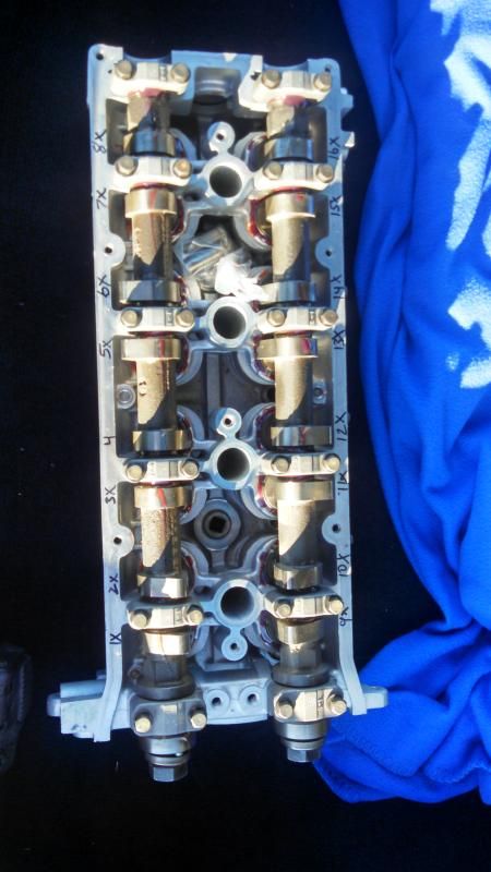

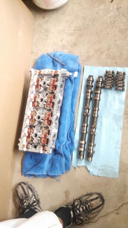

when I took my head to a machine shop (just the head mind you) it totaled about $600 and I only had to replace the Exhaust valve guides everything else was good and reused. It included the below:
-complete disassemble, cleaned/hot tanked
-resurface head and pressure tested
-Spec/measure all the parts in the head (valves, valve guides, etc)
-3 angle valve job
-setting valve lash
-complete rebuild gasket kit (head, exhaust/intake mani, egr, throttle body, injector o rings, etc)
-New OEM head bolts

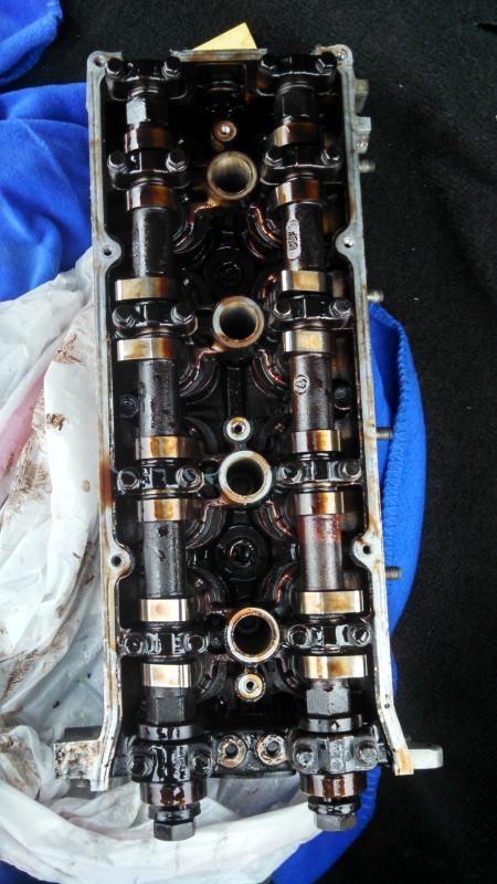

Here is what I took in
and here is whatI got back
