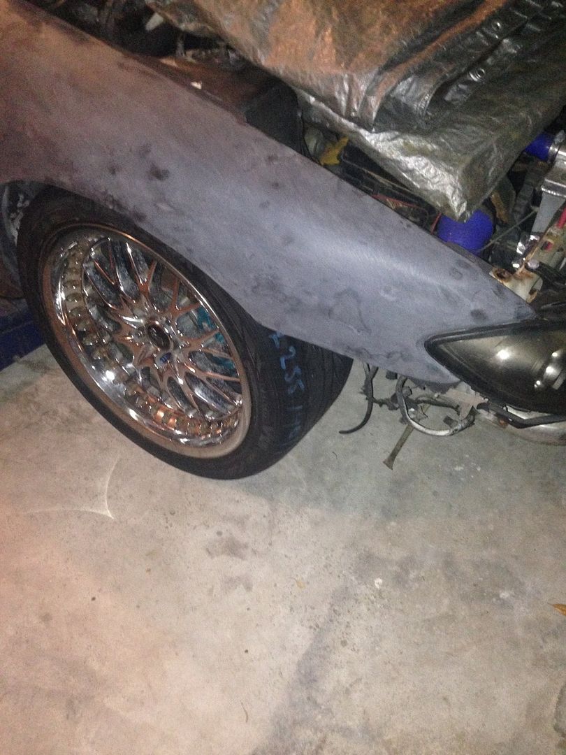

Unless you know how to body work, spend the money up front.
I have extreme dimensions s13.5 conversion fenders. One fender fit, the other needed excess around the mounting tabs ground out.
One of the fenders was obviously out of a shittier mold I expect has been raped for the last century.
Low spots every where, poor alignment with headlight up front, grooves along the hood line. Just absolutely horrible quality.

Sorry it doesn't show the whole thing just a pic I snapped tonight. Couple hours of fitting, sanding/primer. Still needs a third round of primer, one of the mounting tabs at the top by the door broke off (shitty excess I had to trim to get it to initially fit caused it to be weak) door gap is mediocre, wheel sits too far forward. Bracket must be made to push the front of the fender off the wheel or it will break like last time while turning
