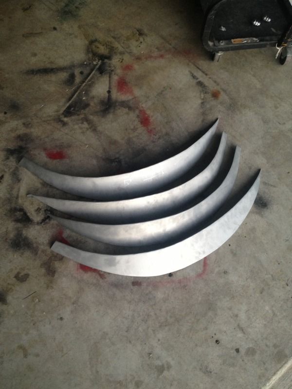

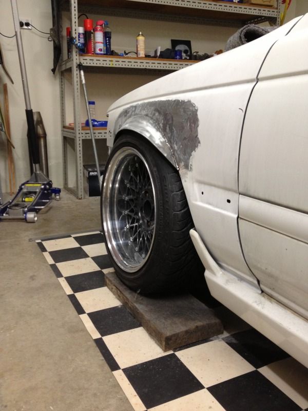

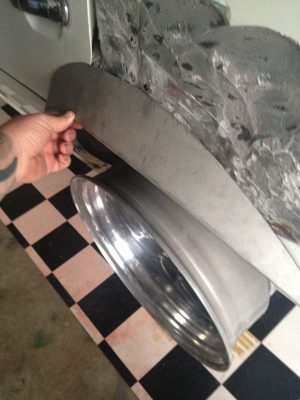

I'm doing similar but on a four door. Made a template then a jig out of timber. If you make your template, then add 10mm onto the lip, put it in a jig with the 10mm hanging out to bash it down 90degrees, then take it out of the jig and bash it all the way over and it forms the flare for you.

That looks pretty smooth, Andrew.
What thickness material did you fashion those flares from?
Could you display a picture of the jig that you created?
