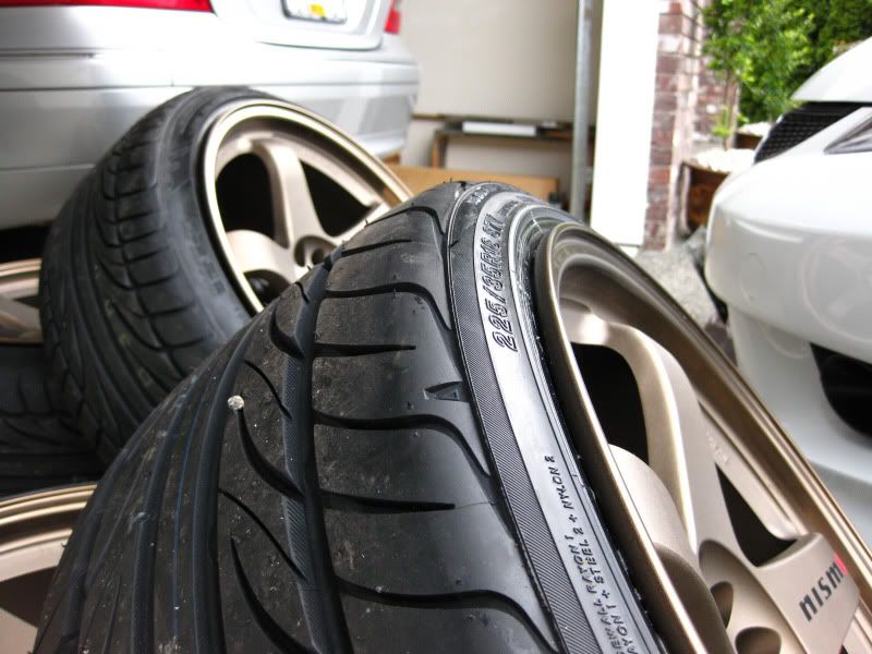

Hey guys, looking at tires right now and ive settled on getting some yokohama s drives but I just want someone else .02 on this tire setup. I feel like I can get away with it since I baby my car, dont slide it or beat it. Also have some FA500s just waiting to put them in along with new shoes. Running 7/6 spring rates so it should be a fairly easy and comfortable drive. Dont slide the car or beat every time I drive.
I've already order some 18x9.5 wheels te37 style. Tried getting the real deal and cheapest ive looked in months on YAJ was 15 without shipping. Being realistic I just dont have or want to spend money like that. I've already spent money else where on quality parts and taking my car as restoration not a drift missile.
For tire setup I was looking to get 225/35 on the 9.5, they will be stretched but looking at another user hear the tires run a bit big and dont seem crazy. Look fairly clean and practical.
Only thing stoping me is how well they will feel and being this is my daily if its a smart idea. I drive about 150 a week working full time with work/school from 8-8 mon-fri. So in a year ill put roughly 9k give or take.
Plan is also run the same setup when I go to swap in another built longblock. Im push 10psi on stock ka on e85. Engine is running great and only issue is chattery puck clutch that ill be going white bunny next time.

18x9.5 +12 will REQUIRE at least 3-4 deg of negative camber to fit under stock fenders! sell the wheels, buy something thats in the 9-9.5 +40 to +35 range and run some meaty tires like a man!!! rubber band tires suck!
the ride will be fairly hard and shitty... after switching over to meatier tires on my current S13 (i use to do the stretched tire thing on my last S13 coupe), i find the ride to be much better along with WAY better handling given the tire actually functions properly!
this is my current setup... 17x8.5 +30 225/45R17 upfront and 17x9.5 +38 245/40R17 out back (changing to 235/40R17 and 255/40R17 soon) on -1 deg of camber.
the 245s barely clear the fenders in the rear... my fenders are rolled flat with no pull.

this was my last 240 on 18x9.5 +15 wheels with 225/40R18s all around (i THINK they were 40 series). fenders were rolled flat and slightly pulled in the rear with maxed out camber front and rear.

Looks like im just going with 18x9.5+12 all around, front will clear if I run 225/40, slight stretch but will be alright. Depending on how high I want the wheel gap is how much camber to run which wont be more than 3 degrees.
This is 225/40 18x9.5+12 front and 245/40 +15 with heavy rear pulling on fender and tucking it.
18x9.5 +12 18x10.5 +15 no spacers, 225/40/18 all around -2.5 rear camber -2 front
