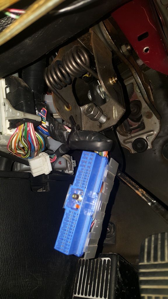

Have 2 connectors just dangling on the driver side under dash on my 95 s14. Not sure what they are. Ive searched and everywhere says its the ecu plug. Any help please

That's an ecu plug alright. On the wrong side of the car though. Funny.

They're the automatic transmission and shift lock control unit connectors. If your car isn't automatic, you won't need anything connected to those plugs. Tuck them back up under the dash where they came from.
