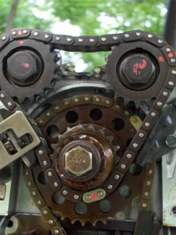

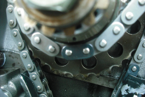

Is my lower timing off? AFAIK the idle sprocket dot should be five links from the guide on the right. On the fith link should be in the middle.
First picture is at TDC, second is 5BTDC, and third is a picture from a thread fixing incorrect lower timing without taking off the front cover. Cam timing looks perfect.
I am not familiar with checking the chain that way, so if you trust the info then we can scratch that off the list. My thinking is that any difference in slack could put yours at a different spot than that picture.
In the second photo it looks further advanced so did you mean 5°ATDC? or are the pictures reversed versus your description?

Releasing the upper tensioner causes the chain/cam/idler position to move.
If the chain is OK, you can run a quick check on the injectors:
Already know the injectors fire and took off the rail and spun the dizzy to see.
As far as 5 ATDC thats not right. On the crank you have the little timing marks. First picture is on the second mark going from left to right. The second picture is at the first mark on the crank
just like in this picture
I've taken it off about 4 times now to do the top cam timing and everytime from what i've noticed the sprocket links havent moved and car ran the exact same.
If it does cause it to move then how do reset the sprocket without taking off the pan, crank and front cover? Didnt you just finish the spare motor? Im sure you can reference either one of the pictures I posted.
You chains looks fine

Yes then you are right so im guessing timing is off 100%. If im getting "TDC" marks at 5BTDC then im off a tooth on my sprocket. Look at all these other pictures and you can see theyre half way. Im 90% most of these are at TDC since the posters on the threads I got them from just did there timing so im assuming the motor is still at tdc for them.
Even checked the fsm diagrams and its the samething, at TDC its 5 marks with the last on by the guide with half of it below it. EM-17 if you want to check.

I'll try and dig up some pics tonight

I looked through those pictures (thanks for linking them). And I am going to say you are fine. The 5th link top pin would be touching the top of the tensioner if you were off a tooth. Everyone is going to see TDC differently depending on how your look at the pin on the front cover, and everyone is taking a shot from a different angle. Kind of need to average them all haha.

So an update is I took my dizzy out and realigned it. Looks like I was off a tooth everytime I put it in, I thought the metal part that spins was supposed to point toward the bolt hole and NOT turn as it went it. Looks like your supposed to line it up with that then it turns a bit upwards closer to the dizzy plug and sit right under the spark #1.
So knowing that when I did my timing I got 20 degrees when it was a tooth off and now when I time it with it in right im getting 15 degrees with a timing light and the dizzy fully turned to the right.
So with the dizzy right and I cant get my base idle to 20 then my lower timing is def off. Going to see if I can adjust it without pulling the whole bottom cover.

Another update, looks like my lower timing was off half a link...
Took off the whole front cover assembly, redid it and slapped the crank pulley on. At TDC on the crank I 100% get that half a link!
Im guessing when I was putting on the tensionor the left side of chain had some slack when I was doing the longblock and the chain moved over a link. So note to self is keep the marked side of the chain under pressure the whole time.
Will post pictures up later tonight. Hopefully I get a good start, seeing it line up now looks to be my issue. All goes good will be driving just before the 1 year mark when I took the car apart.
