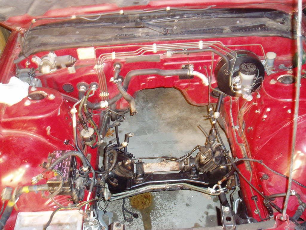

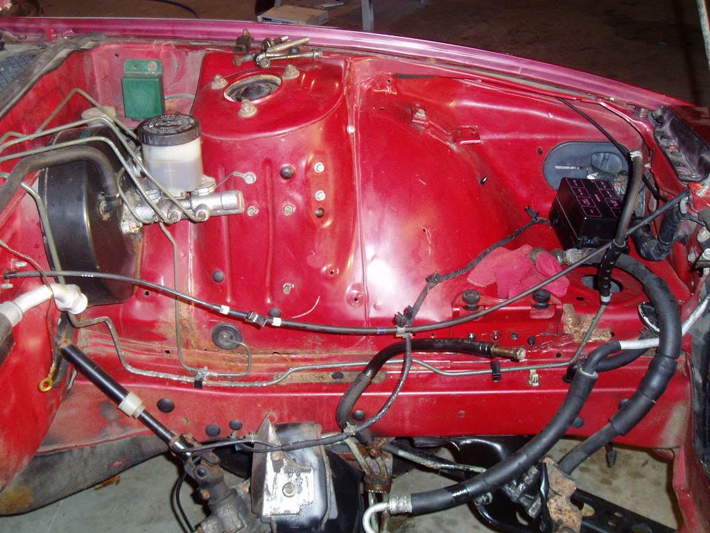

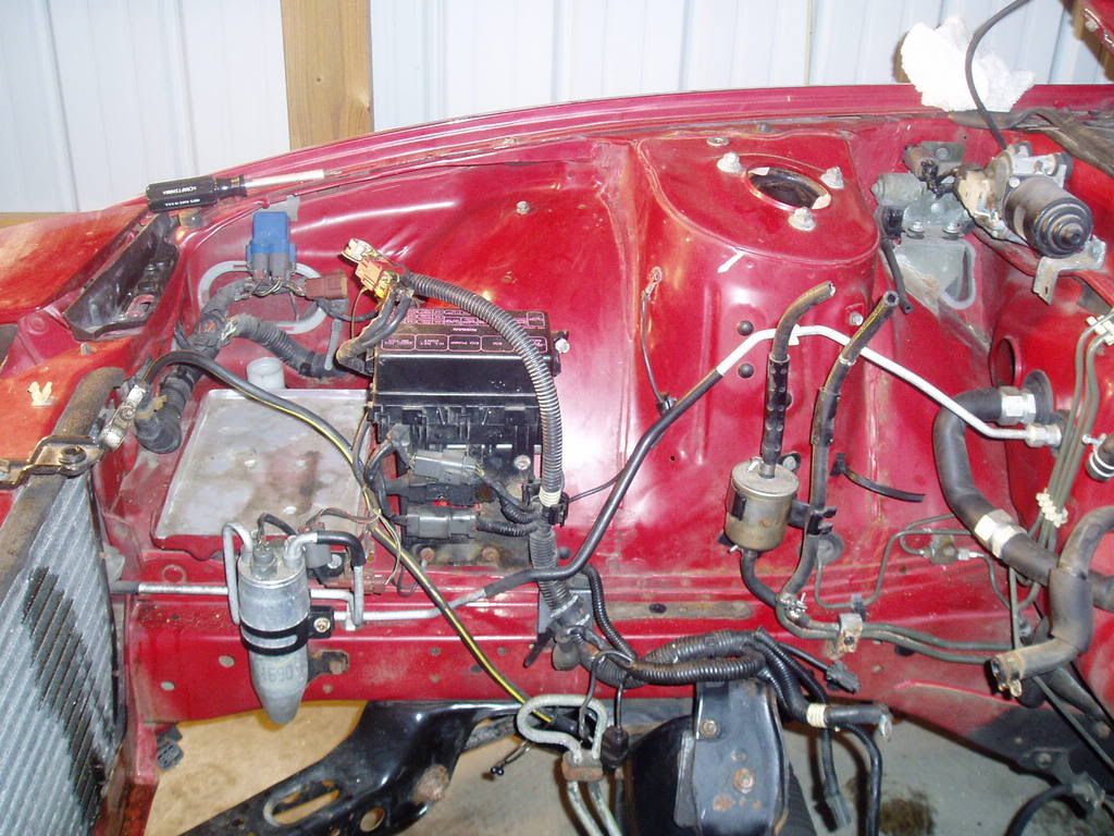

I know it's dumb, but I'm a little nervous about the swap. about a year ago, I pretty much recklessly tore the car apart, unpluged everything, yanked the motor, and now that it's getting really close to engine time, I don't know if I might be missing something or if anybody has any suggestions, so take a look at the pictures and let me know what I'm dealing with.

Oh yea, and whats that bullet shaped canister in the first pic right next to/below the battery tray? Is it necessary?

Depends, wanna keep your a/c?

Okay, I thought it had something to do with HVAC.

Yeah, that's your drier for the AC system. Looks like you system is open so you will need a new one.
I don't have a S13 so, I can't help you. but, you may want to DL the FSM and it will tell you what you need.

I had another question, sorry to thread jack, but wtf is this for?

We rip that off, if i remember correctly, its evaporative canister related for the KA. Hence, you dont need it. I think its a vent coming fromt the gas tank that ends into a canister on front rite side where the air filter used be at.

I think it ended at the ugly black charcoal canister that I, oops...broke off.

yah that is the canister line, It can be removed, I thing it goes to a soft line, then back to a hard line, I think I just took it out from the soft line and left the soft,

ok cool, cause I was doing my FMIC and I saw this and it wasnt pluged into anything. Thx
