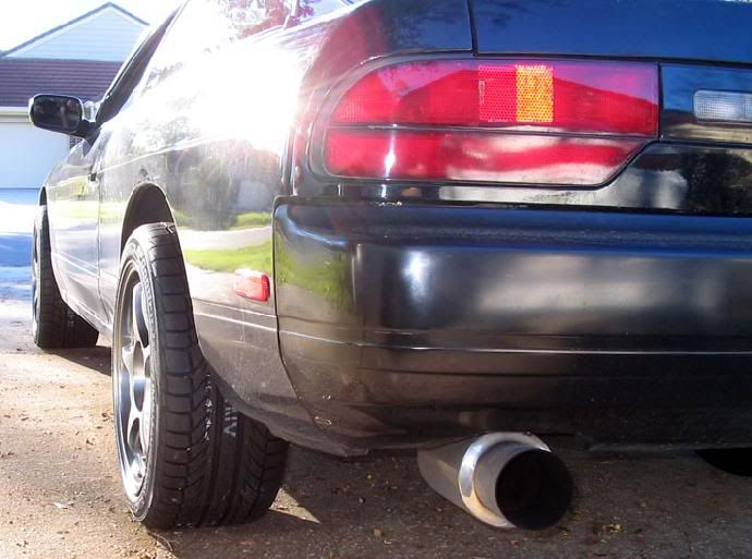

rolling?...no way....30 min, for all 4 corners, with a hammer to those inner fender lip things and it'll fit fine...add some minor camber and you'll be pimpin...(they just say rolling required to cover their asses since with totally stock fenders and no camber you'd rub a lil)
i ran 17x9 +9 offset on stock s13 fenders with just the lip hammered up...2 degrees camber (and i didn't even NEED that much, just wanted it)
