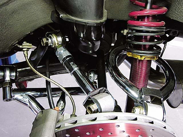

I know a lot of people want a few degrees of negative camber for their cars for drifting, but i drive across the country twice a year in my s13, and right now i just want 0 camber (or near there) so i dont wear down my michelin pilots too fast.
I have heard that you can just slot the rear upper control arm holes and save a good 300 bucks that could otherwise go into other needed mods. Has anyone done this?? Does it hold up to drifting well??
I have the sportline/blues setup, btw.
http://www.240sx.org/links/installs/camber/camber.html
