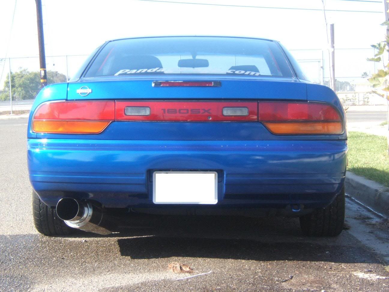

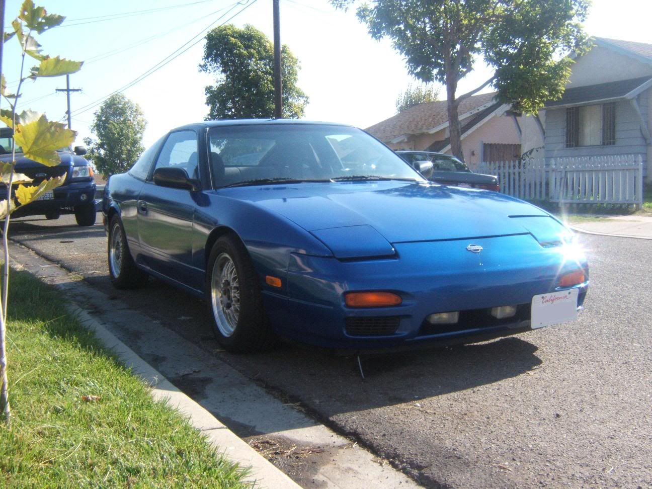

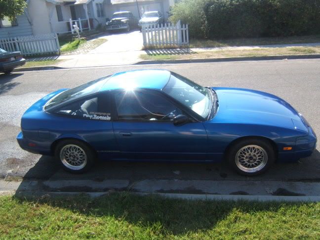

heres the wheels on the car i forgot to take a pic of the spacer, but thay have held up fine, but i still dont plan on drifting on them.

nice, can you post some pix of how they look from the back. i wanna see how far the stick out.

.::SR20_240::. is on the path to ruin.::SR20_240::. is on the path to ruin
Send a message via AIM to .::SR20_240::.
.::SR20_240::. is offline   Reply With Quote
