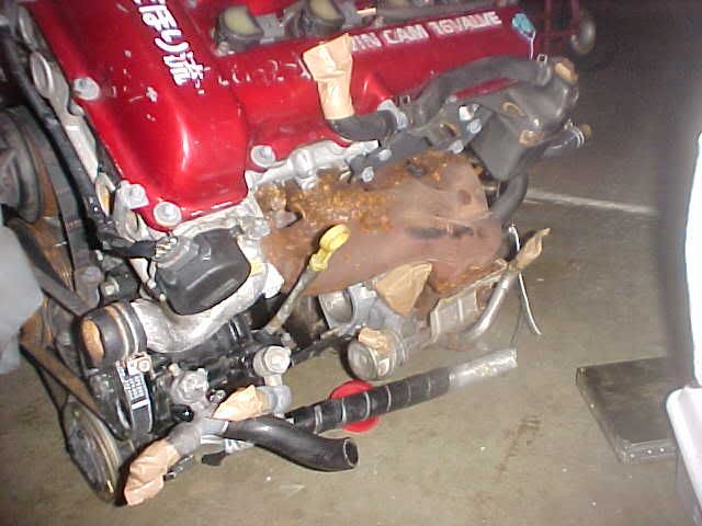

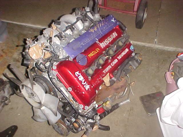

SR jsut got my redtop, check out the pix let me know what yall think ?
wahts up every1 i jsut picked up my redtop sr20 i got it for $2300 .... but i dont know it duznt look in that great shape or maybe its jsut me take a look at the pix let me know what yall think >?

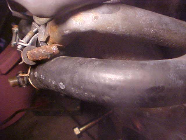

the only problum i saw is that there is a hose that is broken i dont know what hose it is to the engine or what it duz or if its a huge problum if sum1 could help me out with what the hose is that be mad kool !\/
and also i noticed alot of rusting is that normal to have for a engine that has under 50g?

its been sitting around for a looong time.
break out engine degreaser and get to work.

you broke the coolent lines that goes to your turbo.
you paid alot for just a engine set. good luck.

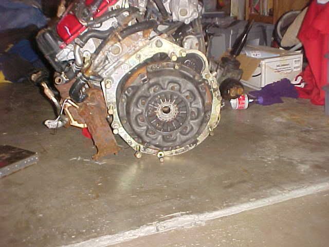

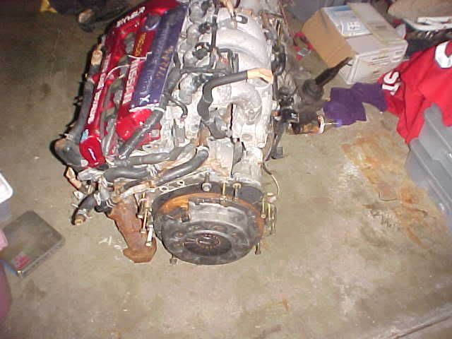

And you have it sitting on it's oil pan instead of on a stand.
Make sure the pan isn't dented. Pull it off and check for metal in the pan too.

wow....that engine looks ROUGH

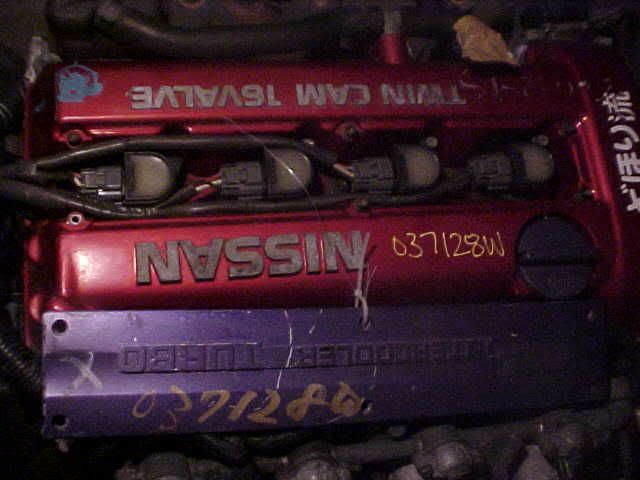

I think you all are just jealous of the purple plug cover!
Seriously though,.. I would try and find a motor that looks like is hasn't been messed with. No paint, no boost controller, no HKS filter, just Bone stock. I turned my first SR away because you could see where an SAFC was wired in the harness. Messing with the fuel means messing with the boost and I dont have time to troubleshoot someone elses mess.

not only is the purple plug cove hot, but so is the purple oil cap. haha, i gotta wake up in 2 hours for a drift event and i am REALLY fcukced up. haha

I didn't read all the other replys, so I'm probably not the first to say that the broken line is the coolant line for your turbo. And you paid alot for what you got. I got an S13 redtop, tranny, harness (minus ECU and MAF), intercooler, piping, and gauge cluster for $700 (normally this would go for probably around $2000-$2200 tops), but I have some connections otherwise I wouldn't have gotten that price. But $2300 for that is to much, it looks like you got the engine, tranny and not much else. I'd take that back and go through somebody else for another one. And BEFORE you PAY ask them to do a compression test, take off the valve cover and then you should also check the turbo, and pull out the plugs. If you know what to look for, doing this should tell you if the engine is in good shape or not. If you don't know what to look for, find a friend or make one who does. And if you don't have a stand, at least leave the tranny and engine mated so the thing sits up level on its oil pan on something (even a pallet with some old carpet on it will work, just don't drop it on it's pan, and pull the pan off before you put it in. SR's are very picky about dents in their oil pan...trust me

Man starting to feel bad for the guy everybodys giving him a quick kick in the pants over this one. :hammer:
You got the motor so I say bolt on the tranny and starter, pop out the plugs, open the throttle plate, and use a car battey to turn the motor over and compression test it. If you get 145 - 170 psi (and each cyl is within 10psi of eachother) you have a sound motor! At that point wire brush it, degrease it, throw away the :ghey: plug cover, powder coat the valve cover and drop that baby in!!!
I have made some raggedy KA's look real nice after so work.
If it has sh!ty compression like 130, 150, 160, 130 - take it back and cram it up their a$$.
Hope this helps!

Well, first of all, that engine looks like shit.
Second, it's way overprice... fuck, I got an MKIII 1JZ front clip for less than that...
third, nominal compression readings according to FSM are: 156 psi on all cyl, within 14psi difference. Low = 120 psi and less..
