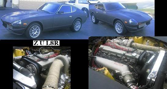

Sold the car to a close friend of mine. Here is the list of the mods it had, in case someone has similar goals in mind or u were just curious to wtf i had done to it.

*SUSPENSION*
energy suspension complete bushing kit
toyota 4x4 4 piston front calipers
*RIMS*
Riken 14x7's with bfg t/a 245/60/14's in the rear fronts are 215's
*INTERNALS*
Commetic Metal HG
ARP Head Studs
(that's it for these dyno's, first motor lasted 7 months, timing belt idler pulley locked up, shredded timing belt = bent 19 valves, dropped new motor in /w hg & studs, lasted a month, was at the drag strip and drove it home with uber blow by.the plastic vacuum T to the fpr/profec cracked so it under fueled & over-boosted aka leaned out the motor and fried the piston/rings. after that i did wiseco 8.5:1 pistons +acl bearings + new oe oil pump, lasted a couple months then threw a rod on the dyno cause the stock rod bolt snapped...worst thing was i paid for pistons,rods,bearings, & machine work, and got everything but the rods, but i put it back together instead of bitched about it so...that's on me)
*MODS*
GReddy intake manifold
GReddy timing belt
GReddy Profec
Walboro 255lph inline fuel pump
Q45 Throttle body
Z32 MAF (blow through)
Z32 n/a 5 speed transmission
OS Geiken Super Single 6 puck unsprung clutch & flywheel combo
Ebay bar & plate fmic 25" x 11.5" x 3" core (27.5" from tip to tip)
Apexi Power FC
DeutcheWerk 550cc side fed injectors
Precision GT30/76R .63 a/r hot side, .60 a/r compressor side
XS Power top mount exhaust manifold (had to angle the turbo flange away from the valve cover a little so the compressor housing could clear it)
Tial 38mm external wastegate (9-13lb spring)
AFCO aluminum racing radiator
N1 water pump
Gizmo phenolic intake manifold gasket
BCPR7ES @ .028 or BKR7E @ .028 gap
Buick Grand National Ignition coil pack
MSD 8.5mm Wires (if u buy the v8 kit they're longer than the v6 kit)
Blitz Bov
Magnaflow 3" muffler
*THE MEN BEHIND THE SCENES AND SPECIAL THANKS TO*
Wouldn't have done it without these guys
motor mounts by Joey Dacus @ Landrum Manufacturing
Intercooler pipe,exhaust, transmission mount & other various fabrications done by Turbo Dave @ TDF fabrication/mainstream
Tuned by Turbo Dave
Basically I'm not the best welder/fabricator so i had those fine fellas handle that for me. Everything else I did myself. My specialties are engine diagnostics and Wiring.
thanks also to all the guys at Mainstream Performance, Top Hat Performance, Lethal Injection and everyone else for their help and support.
*TMI*
I drove that 280z for about 2 years with the stock L28E around, then finally rb20'd it. the rb20 was ok for a couple months and i had this rb25 waiting and waiting and waiting for the 240z to be finished but it didn't, so i said f@#^ it and put it in the 280. Got a lot of kills with the Z.....
