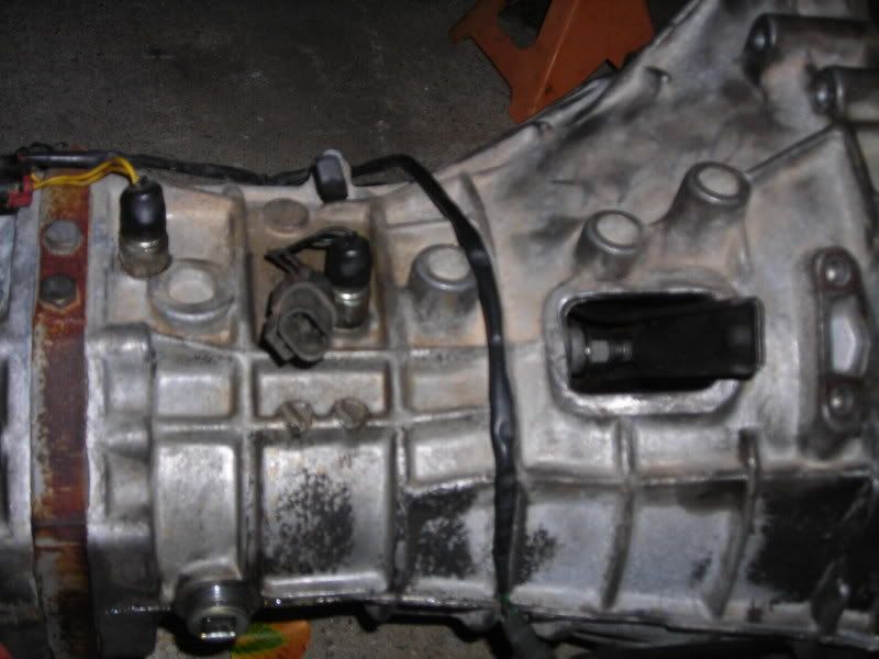

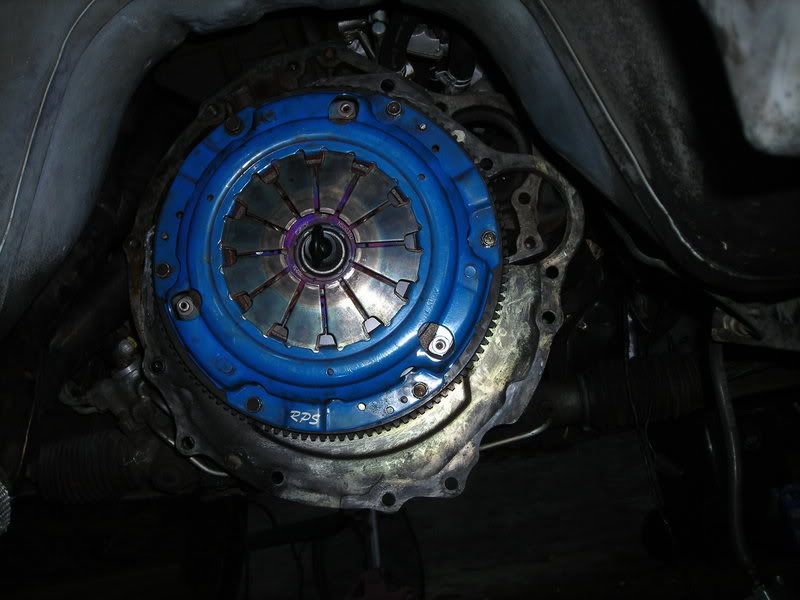

Old 10-29-2007, 04:48 PM   #19
nissandr1ft
Join Date: Sep 2004
Location: Clayton, NC
Posts: 284
nissandr1ft has a spectacular aura aboutnissandr1ft has a spectacular aura aboutnissandr1ft has a spectacular aura aboutnissandr1ft has a spectacular aura aboutnissandr1ft has a spectacular aura aboutnissandr1ft has a spectacular aura aboutnissandr1ft has a spectacular aura about
Send a message via AIM to nissandr1ft
Update:

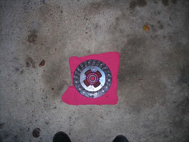

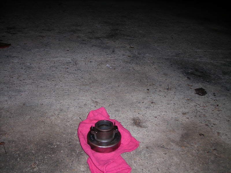

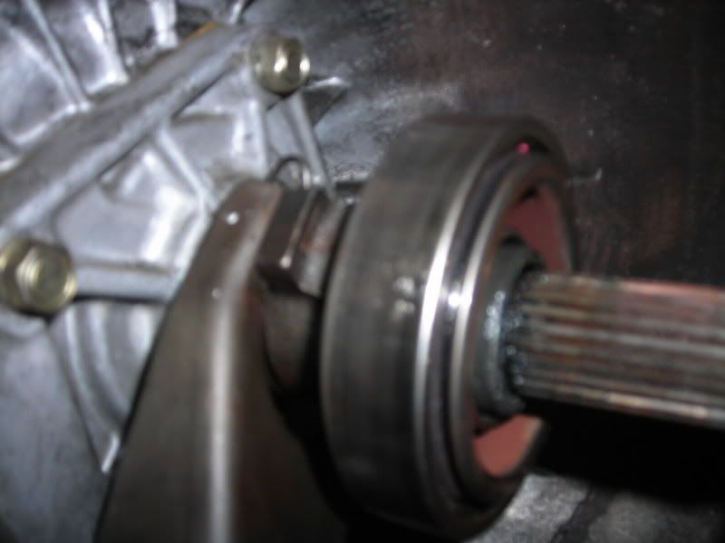

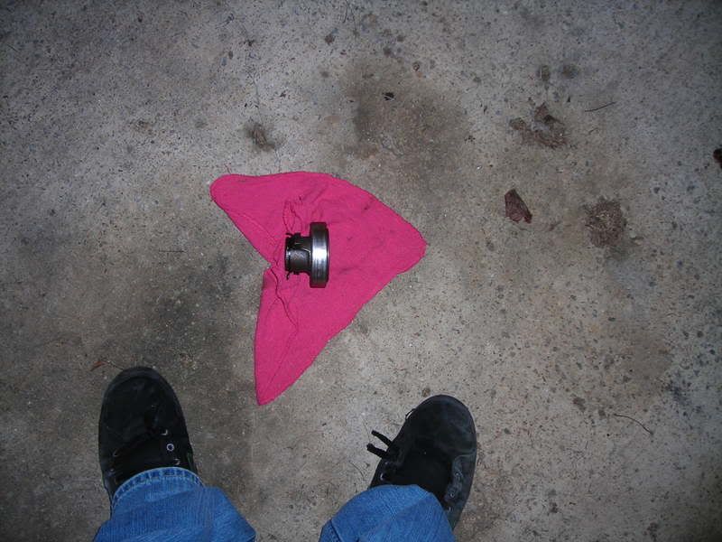

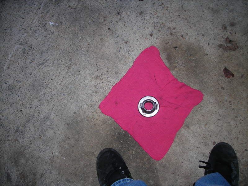

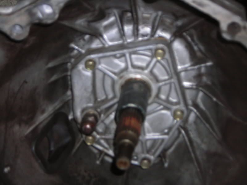

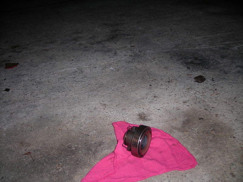

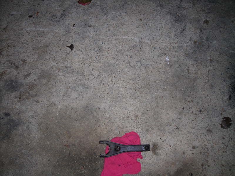

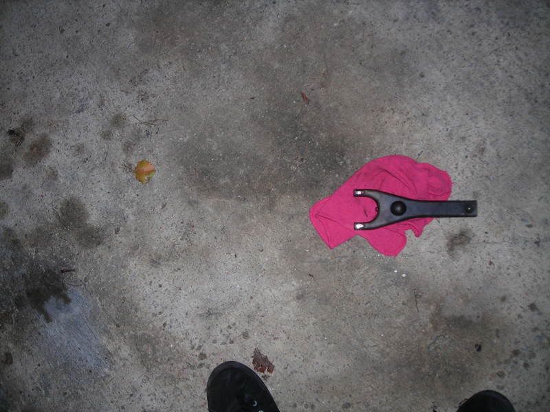

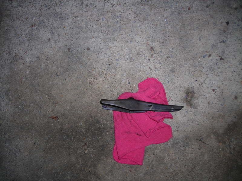

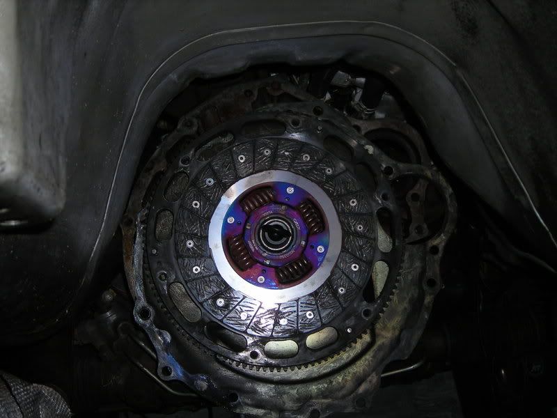

Clutch is out, everything looks like it should, and Im stumped. The disk looks fine since its not missing any springs, and the surface looks fine. The pressure plate seems to look fine, and springs all feel fine. The pivot ball is fine, and the fork is straight. The throwout bearing spins freely, and structurally looks sound. Ill get some pictures tonight, and see if anyone notices something wrong.
www.carolinanissans.com
nissandr1ft is offline   Reply With Quote

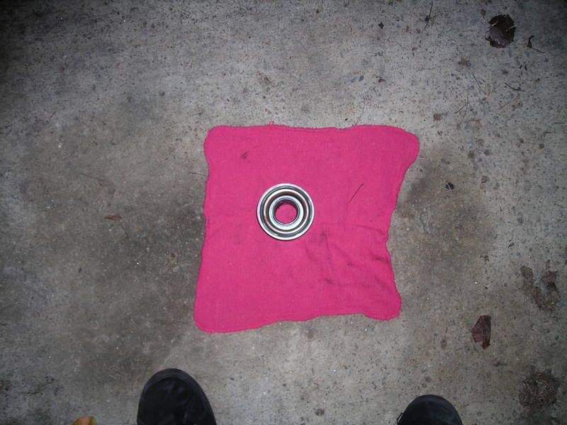

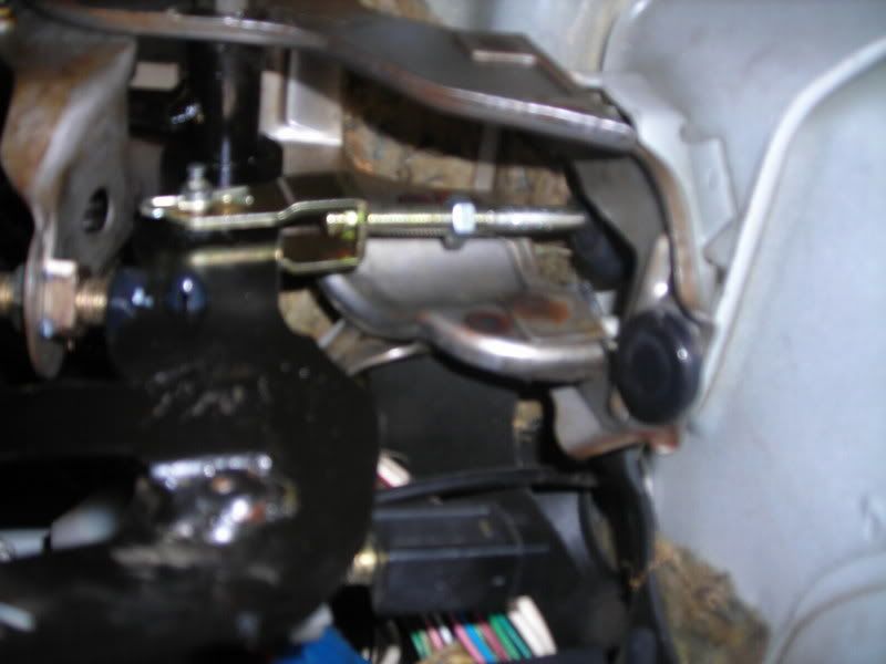

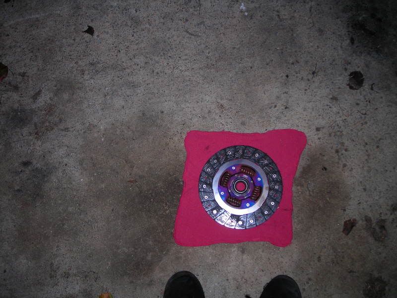

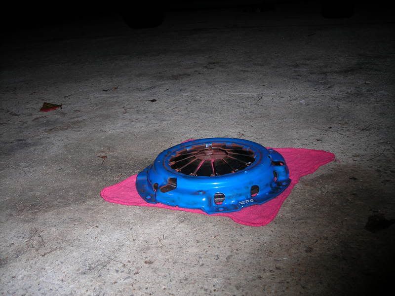

Old 10-29-2007, 05:46 PM   #20
nissandr1ft
Join Date: Sep 2004
Posts: 284
Pictures:
Old 10-29-2007, 07:19 PM   #21
nissandr1ft
Join Date: Sep 2004
Posts: 284
I did notice almost immediately when bolting the pressure plate on that the springs caught quickly. Usually on the previous clutches the springs didn't move until the last little but of tightening, where as these did pretty much did as soon as the bolts caught thread.
