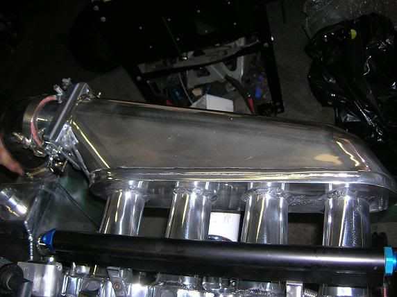

Vinnie, you know the comment on the last page about doing the internals, well yeah.
Went back today to finish tuning. Just about had fuel all worked out, turned on the Haltech boost control (which is fucking sweet!) and then we hear some gnarly snapping/weird noises after one of the pulls on decel. #1 cylinder comp tests out at 90psi. So it looks like the ring lands blew on #1. Don't know why, we were only running about 8psi and we didn't boost spike, detonate, or go lean. Everything thing was great. Made a little over 270hp too. Hadn't even gotten into ignition tuning. haha it's gonna make a LOT of power. Had to do 4th gear pulls because it was spinning the tires in 3rd. I'll post up the sheet sometime soon. So now I get to build a motor. yay. Right in the middle of event season. Oh wells. What's another 3 months, eh?
But on the up side I'm just going to skip the whole 10psi tuning thing when I get it back together. 1.5bar here I come!
RBS14 is offline   Reply With Quote

That sucks to hear man.
I'd look into that intake manifold over feeding the number 1 cylinder. The way you have it setup doesn't look too hot IMO.
If I were you Id cut along the base and add a 1-1.5in angled spacer or something along those lines. In the pics it looks like the inlet is actually blowing on to the #1 velocity stack at a 90 degree angle with the stack protruding into the flow, which would suck balls for proper air distribution...
But I'm heading down the same super response tune path you are, GTiR Turbo, GTiR ITBs, V-mount, Lightweight Driveline, 256s, and all the tuning/bolton goodies to make it work right... I need to start rounding up parts.
Thats interesting. I thought the manifold would pressurize and and be pretty even? It makes sense though if one runner is getting force fed air like that, it would be running lean.

I designed the manifold like that for a reason. You want the air flow to get broken up (so to speak) and allow all of the plenum to pressurize before any of the runners are fed any air. That way they all get the same amount of air at the same tim. Either way we'll find out because when it's all back together we're gonna test the AFR in each runner simultaneously at a few different loads and rpms to see how far off from eachother they are. Then I can do individual cylinder trims in the Haltech to fix it. We'll see.
Actually Scott I looked at your plenum again and there are some problems. I believe what McRusselPant's is trying to tell you is that most air density will feed to cylinder 1. Using a plenum design with a straight through plenum causes starvation to cylinders furthest from cylinder 1, cylinder one when it gets overlap at higher RPM will always take in more air than the furthest cylinder.
In order to maintain a stable more accurate flow pattern the plenum should use a cone shape design not a strait through design. This basically means that air pressure will become more stable as all 4 cylinders attempt overlap at higher RPM. Either go with a cone shape plenum, or use a straight through that is literally three times the size that you already have.
Ivans is a perfect example of a cone shape plenum using more square volume at the begining of the plenum, and less towards the end. This will reduce cylinder 1 from consuming more air at higher RPM during overlap and scavaging.
On another note you won't need fancy forged pistons. Altima/Exterra/frontier 1998 and above pistons use thicker ringlands, and are more suitable for boost with a CR in the 240sx engine at 9.2:1. You will need forged rods to make over 400WHP though it will startto get risky high reving with that long rod/stroke ratio.
